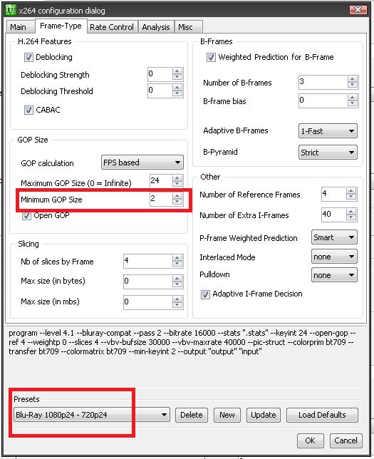

  1. Maximum GOP Size = 10 000 - even more, depends how long we watch voiceman speaking about forecast on TV
    Minimum GOP Size = 1
    it is obviously why this is very optimal variant and why:
    Maximum GOP Size = 250
    Minimum GOP Size = 25
    is like noob driving his shiny new car ..... or jet engine powered with house coals
    Open GOP - enabled
    - this will give around 2% smaller file size of final encoding

  18. max 250 frame GOP:
    x264 [info]: frame I:1002 Avg QP:15.66 size:74725
    x264 [info]: frame P:51096 Avg QP:18.71 size: 25205
    max 10000 frame GOP:
    x264 [info]: frame I:616 Avg QP:15.78 size: 79208
    x264 [info]: frame P:50925 Avg QP:18.70 size: 25333
    saved bitrate goes there, with bold green, we have better I frames (79208 vs. 74725) and with bold red P frames (25333 vs. 25205) - so we got improvement in quality of I frames, and nothing bad happend to P frames even a bit high size --> and B frames will be based on better I and P frames, so overall quality will go high
    and question about x264 stats ........--->
    I frames -
    1.Avg QP:15.66 size:74725 - 2.Avg QP:15.78 size: 79208 - this second (2.) stats should have better average QP because Average size of I franes is bigger, but how we can see it shows that it is lower (15.66 <->15.78)............. the number of I frames is meaningless because we have average size of I frames
    no need to set max GOP to 10 000, 1000 - 2000 is enough
    and also very important is Minimum GOP Size = 1, so where we have big change in scene we will always use I frame as first (in new scene) which have better quality than P frame as first
    analyse by Director X

  26. on picture is standard profile provided in MeGUI and min GOP size = 2 (it is ok), but max GOP size = 24 maybe they have video where change of scenes is every second ha ha ha ........ and this is Blu-Ray specification profile .........who knowz

  28. Originally Posted by somespirit View Post
    Yes, blu-ray has many rules for compliance.
    Each restriction that you have to follow in order to meet compliance potentially reduces quality
