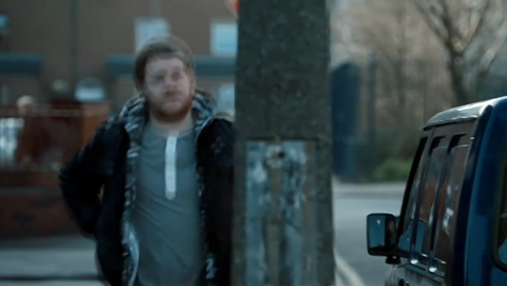

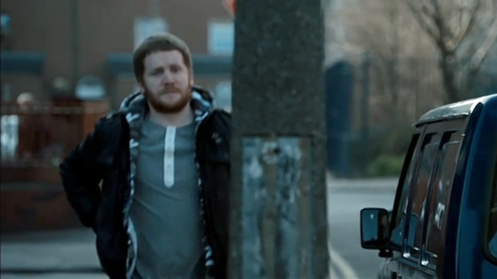

    I uploaded longer version with yadifmod/nnedi3/srestore, same script as above
    IMO QTMGC does better (as it should) in most scenes (e.g. you can see aliasing in the 1st scene with yadifmod), it's only select sections where yadifmod/nnedi3 does better job. If you were picky you could mix/match sections in the script, or tweak the settings for better results. But the cadence is fine with the srestore script

    This comment was just referring to the deinterlacing quality differences between QTGMC and yadifmod/nnedi3. Either will be fine if you use the same script with MPEG2Source, and non MT. As I said earlier, in general QTGMC wins hands down with deinterlacing. But your small sample was proof that there are exceptions (and the reason is it's taking blended information instead of deriving from "clean" fields) . This comment wasn't referring to "big" problems in your encodes (where you have messed up field order or lots of residual blends).
    In regards to deinterlacing - If I were doing this and was picky , I would mix & match frames of 2 versions using ReMapFrames() or similar scripts like clipclop() . Basically you mix & match the best frames
    That's way too advanced and over my head - but thanks anyway.
  6. Originally Posted by The.King View Post
    Really - It's not that bad . You're just mixing and matching frames of 2 differently filtered versions of the video. ReMapFrames() takes a text list of frame numbers
    I think most people would be happy with just QTGMC, Srestore . You only notice the slightly blurrier frames in some scenes when you go frame by frame, most people probably wouldn't notice. But the aliasing (deinterlacing artifacts) you can see in normal motion

    I've been trying to explain it over the last few posts - it's a blending/blurring type of distortion. All you need to do is look at the first 3 seconds or so of any sample and you should be able to see it - be it the guy wearing jeans and how his legs move when he walks, or the first close up of the guy in the suit and how the frames move left->right.
    make a screen shot of the mp4 and the scource (same frame!), use a paint program and circle the distortion that bothers you so others can get a grasp of what the problem is.
    Like you mentioned in a previous post about yadifmod, it might work or look ok for still images - but the problem here is noticeable during movement. The distortion I'm referring to is during a moving scene, not when I pause the video, so I don't see how a screenshot would really help? As I mentioned when posting 5 samples - I think the distortion I'm referring to is cealrly visible (not being able to make our someone's face as they walk etc.) when you play the clip. But here's two screenshots from clip 5 anyway.
    What did you make of the 5 samples I uploaded. Can you see the distortion?

  14. okay, that's blending -> only way around it tweak the restore values, e.g. try speed -25
    Roger! I'll give that a shot thanks - only ever brought speed down to -8 before. But if you have one minute, please play clips 3, 4 & 5 (either QTGMC or yadifmod) and you'll see the kind of blending I'm talking about - it's really bad IMO.
  16. compare the scenes with a bob only and you will see if there is hope, if there is no non-blended frame next to the blended frames sRestore can't win,..

    Just to show 4 x consecutive frames and how many are blended - please see attached. This is after the source was loaded & analysed and QTGMC, slower, bob(), SRestore 25fps, limited sharpening, etc. were applied. Not necessarily looking for any thoughts (unless there's a magical cure) - just thought I'd share while I'm waiting on another sample encode to finish.
    Thanks.
