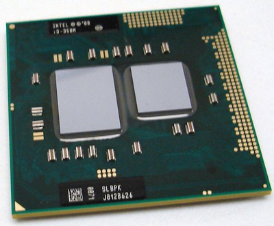

    I took a closer look at your CPU pic. First, the thermal paste seems spotty on the CPU, is should be evenly spread out unless it's dried out, then it mght come off in patches. Second, what's the white stuff around the CPU? If it's thermal paste, it's transfering heat to where it shouildn't be and might be the cause of your problem. Here's a pic of where the thermal paste should be:
    Those two white patches are thermal tape and represent where (and only where) the paste should be. Compare this CPU with yours. Something's definitely not right.
    Well, back to you Nelxon37. Happy holidays!
    Edit: Took anouther look your CPU pic and it looks like the paste melted and flowed off the cores. Definitely not good.
    Are your pics before you applied the paste or after? It's odd how it's thicker in the middle and thinner on the sides. When I pull off heatsniks off dried paste, it's usually the middle that flakes off since that's the source of the greatest heat.
    Also, since you're going to be replacing the heatsink anyway, what type of paste are you using? I use Artic Silver or Ceramique 2. I'm sure there's even better stuff out now. A bit more, but it's lasted for years and numerous CPU mounts / dismounts and really keeps the temp down.

    my pix are from the oEM .. from when i removed the heat sink for cleaning
