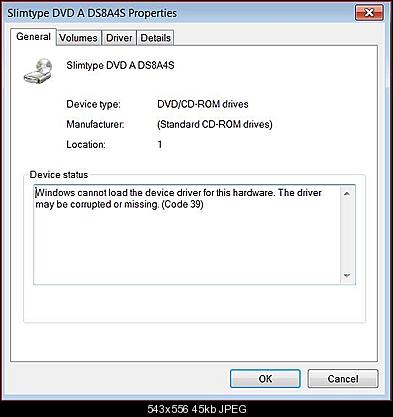

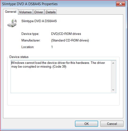

    I now have another problem, yesterday it quit reading the internal & external DVD drives
    my external HHD still work
    although they are identified under device mgr, i get 'could not load driver' msg
    and they show with the yellow ! point,
    i suspect the internal interface card is dying
    and i'm going to need a new laptop
    this one is only 22 months old

    i did the HW disable, uninstall, find new hardware
    all to No avail, same error 'driver not loaded'
    searched online for new drivers
    windows says installed driver is most up to date
    but it won't load it,
    seems like a windows failure
    tried system restore to 12-8-12
    before drive failures
    No difference
    previous restore points have disappeared
    HHD ??, win7 corrupted ?
    repairing/installing win7 from hidden drive partiton D, is going to be a pita,
    likely loose all my files and installed programs
    will have to try a external backup before i attempt this

    but my internal DVD/CD drive is not working and the same thing has happen to the external double layer LG DVD burner,
    this is something with windows and device mgr or the drive interface NOT usb

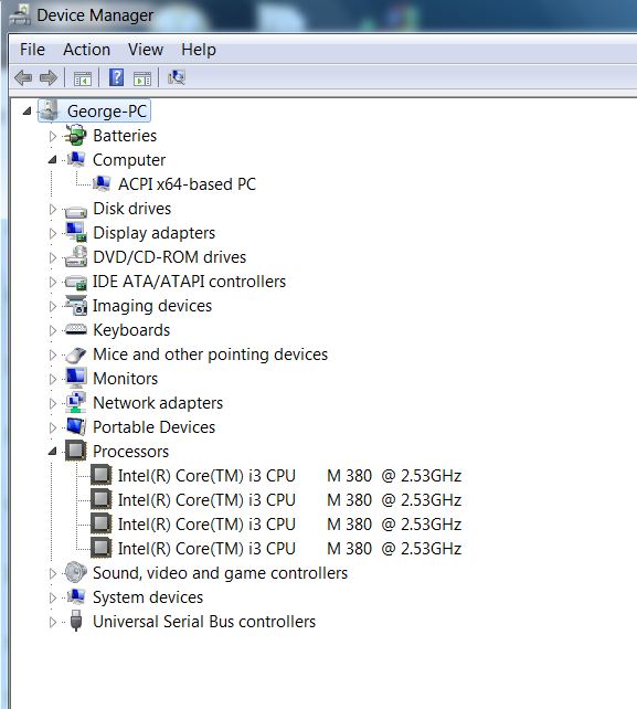

Name:	slimline DVD devmgr info.JPG
ID:	15185Click image for larger version

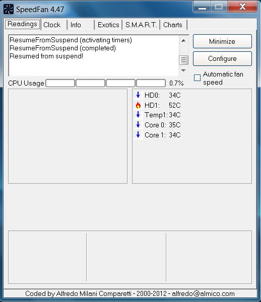

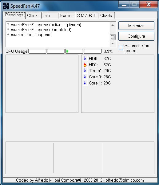

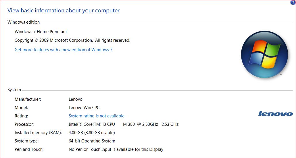

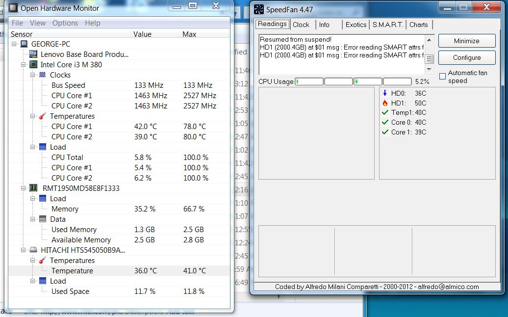

    base line, nothing but a few browser windows open, been on for about 45min
Name:	speedfan base reading.JPG

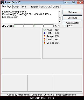

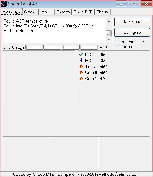

    i did some searching on cpu temps
    and it appears my readings are at or very near critical temps
    I will take it apart and hopefully the new thermal transfer grease will fix the shut down stress problem
    if that works, i can then try to repair the dvd drive problem

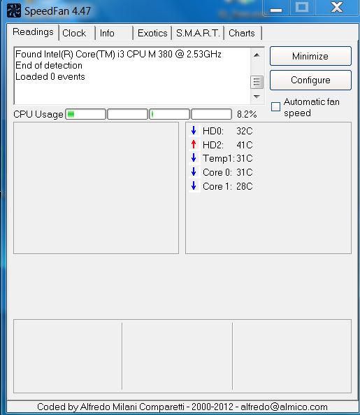

    before doing the thermal repair it shut down at 80c, according to speedfan anything above 50c is warmer thn it should be
    the heat sink popped right off, no problem
    the old compound was very dry and thick
    i used a plastic 'rewards card' to clean it off then used alcohol o clean and prep both surfaces
    reinstalled using the new thermal paste/grease
    it is running slightly cooler unfortunately not cool enough
    and it takes a few minutes to drop back from near 70c to below 50c
    the green check mark comes back at 46c
    it does seem that the cpu is permanently damaged
    at idle with nothing going on the temp is 35c, but the hd is warm
    i don't know why, unless it has been heat damaged
    but that is not the big worry, that would be cheap to replace compared to a new laptop
Name:	near idle cpu with new thermal compound.JPG
Name:	cpu temp at idle.JPG

    current temperature with six tabs (1) window in firefox
  25. Member
    Jan 2007
    the fan is nOT operating correctly
    i have had it shut down and not run when the speedfan and open hardware monitor say the cpu temp is 50c
    i have the bottom cover off the laptop and setting directly over a fan from a cooler pad
    BTW this laptop has 'always' been on this cooler pad/stand since day 1
    i have ordered a NEW FAN and New heat sink on line to replace these
    only 400 miles away should arrive in a few days

  27. Member
    Jan 2007
    then FAN was off at 50c when it should have been running .. 80c was the last observed value before shut down during the stress test before removing the heatsink and trying to improve the heat transfer ... the nEW parts are OEM for this G560 lenovo laptop it's worth $42 in parts to repair, ... the fan is NOT operating correctly... BTW i have tried like Hell to get into bios and get the temp info and fan settings accroding to the lenovo forums pushing delete at startup is suppose to get you to the menu for bios access well on this laptop that doesn't work, neither does F2 , F1 or anyother key i have tried

    current temps with one FF window with 3 tabs
    no youtube or other video
    temps rise fast if i try to get any real work done
Name:	CPU temps at low useage.JPG
