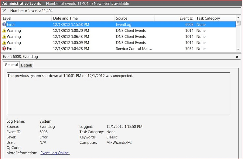

    the event log, kernel power ..
  14. I believe you are already aware that the system did, in fact, re-boot. Now you have confirmed that in the Event Log.
    The possible problem entry would be in the log BEFORE the re-boot, NOT repeat NOT After the re-boot.
    The Application pop-up entries might contain some useful information. The entries listed approximately a minute or two BEFOERE the re-start messages are the ones we want.
    Something you should do, is carefully note the system time, and initiate a re-boot through the start menu. Then, examine the log entries for this time period. Note the processes
    that occur immediately before, and after, a re-boot. They happen EVERY SINGLE TIME. What you are looking for is an entry or entries that are NOT part of the normal
    boot process.
    The message that your system has re-booted does not contain any additional useful diagnostic information.
    A power-off shutdown is fairly unusual.
    IMPORTANT CLARIFICATION - Do you have to push the power switch to turn it back on, or does this happen with ZERO INPUT from you? IF you do not have to do anything,
    then this is NOT repeat NOT a "power-off shutdown", it is a simple re-boot.

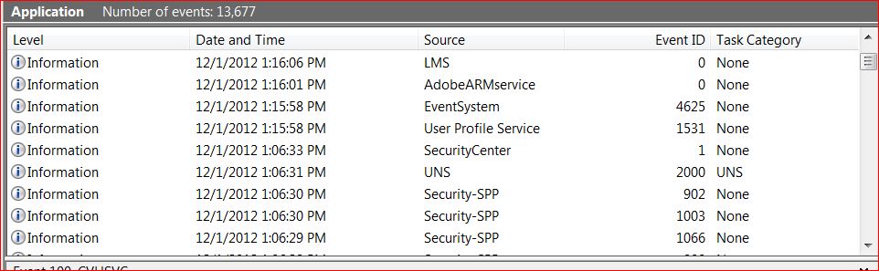

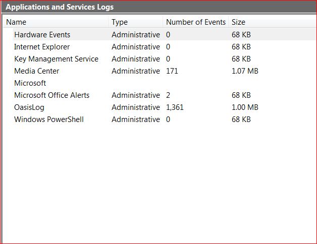

  18. Go to the Windows Logs where you will find the Application and System logs that I referenced. You are looking in the wrong place.
    BIOS test will take approximately 15 - 30 minutes, similar for the Deep Analysis test.

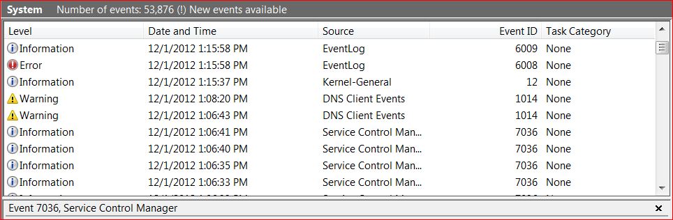

    Jan 2007
    shut down at 1:10
    nothing between 1:06 and 1:15 restart
    windows logs, system and applications
