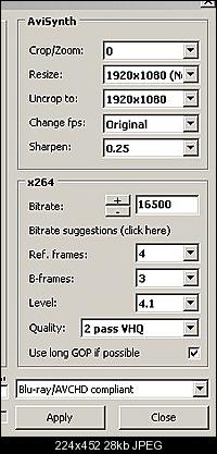

    Okay, so it does seem like I will be able to accomplish what I need with an avs script coupled with multiAVCHD but realized that if I do use a script then I can't use it in conjunction of the multiAVCHD GUI. So if you could help me translate certain elements from the GUI into the avs script then I'd be very appreciative. For convenience I have attached an image of the functions as used in multiAVCHD. The FPS should be: 23.976 and the cropping should be for 3D swapping as in my previous post you corrected.
