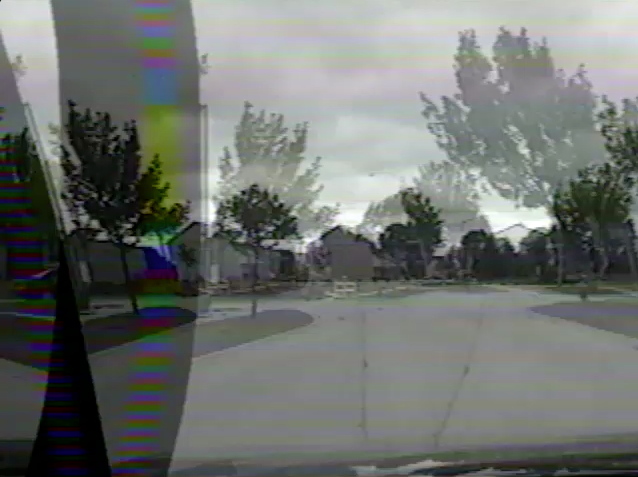

    I have been recording old home movies to my computer using the elgato video capture device. I have also tried with a tv tuner card. Both give the same results.
    The issue is that the video capture records a severe jiggle when camera is being moved around a lot. However, it doesn't show up when I play directly to the tv.
    Here is an example: http://www.youtube.com/watch?v=wFAJba3VxFY
    Any help would be appreciated. Any software or hardware that can help with this? I tried running it through the tv then to the card, but it didnt work. The jiggle still shows up. I assume the Tv out is just a pass through. Something on the tv is stabilizing it. What can i put between the VCR and the tuner / elgato device to do the same? or is thee some software for this?
    Thank in advance
    Dave
Name:	Screen Shot 2012-11-29 at 10.50.52 PM.png
  2. please provide capture device configuration, please provide video standard used as a source (or in other words, what color standard is on tapes - PAL/SECAM/NTSC and what is configuration for capture)
  3. His YouTube profile states USA, so assume NTSC. At a minimum an external full frame TBC between the VCR and capture device is needed. Video that "looks fine" on a TV, but captures garbled is usually false Macrovision detection.

  5. The sync signals aren't clean enough for your capture card (TVs are much more forgiving). A different VCR or a different caputre device might work better. If not, you need a time base corrector.

  10. Yeah, Ill try contacting Elgato first.
    This is on an iMac. I just took a quick snapshot of QuickTime playing the video back.
    I tired capturing on windows 7 as well. same exact result. Artifacts in the same place.
