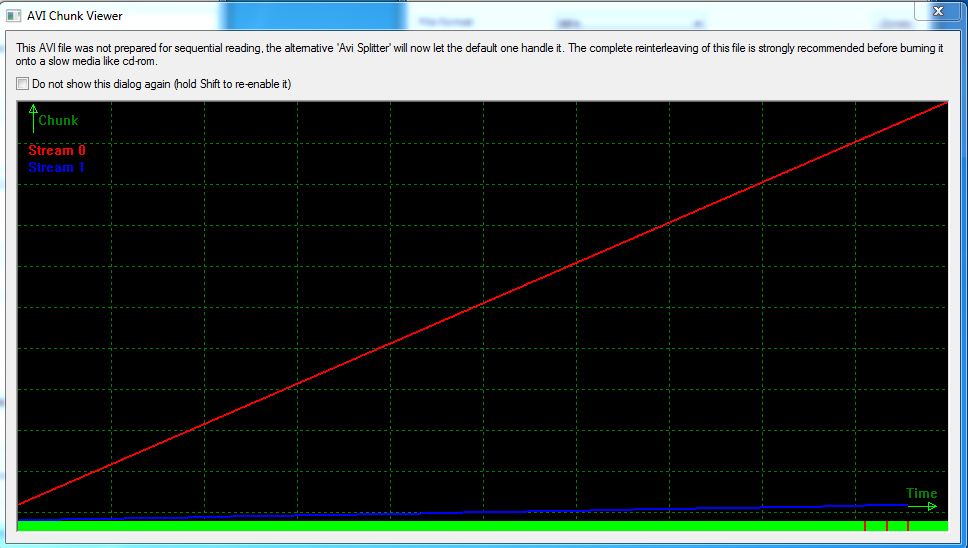

    I have followed the instructions in loading the DBFS in the correct folder. I then try to "Save As" my clip and Debug it as is recommended but I get a strange file called "AVI Chunk Viewer".
    I try to load this *.avi file into MEGUI but it crashes each time. I think I am doing something simple. Please help.

    When the Signpost AVI appears so does the "AVI Chunk Viewer" with a coloured grid and graphs.

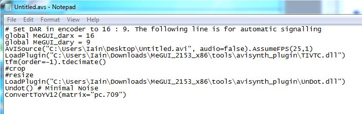

    Here is the .AVS:
    AVISource("C:\Users\Iain\Desktop\Untitled.avi", audio=false).AssumeFPS(25,1)
    #deinterlace
    #crop
    #resize
    #denoise
    ConvertToYV12()
    PS I have never been able to import AVS files into MEGUI or AVSPMod without them crashing. Is there a simple explantory Guide/Video?

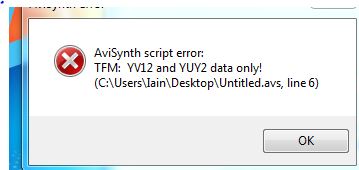

    X AviSynth script error:
    ConvertToYV12: invalid "matrix" parameter (RGB data only)
    (D:\VIDEO FOLDER\VideoClip.avs, line 11)

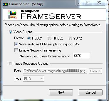

    in vegas, when you start the debugmode frameserver , there is an option settings: format, set it to RGB instead of YUY2 . RGB24 or RGB32 is fine (RGB32 is for alpha channel, but you probably aren't using it)
    Look at screenshot in step 5 in the guide

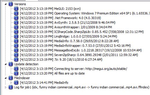

  18. Pleast upload the entire log file ,not a partial screenshot . You haven't included any useful information in the screenshot . There should be a plain text file in the log folder

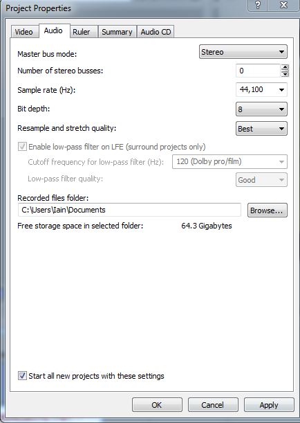

    These are the steps I am following:

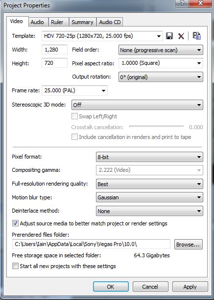

    1) 1) Import my video clip into Sony Vegas Pro 10.
    2) 2) File>Properties>Template>Video Template>Audio Template> OK
    3) 3) File>Render As DebugMode FrameServer (*.avi)>Save
    4) 4) FrameServer opens up: RGB24 > Next
    5) 5) AVI-Signpost appears on my desktop.
    6) 6) I minimize FrameServer and Sony Vegas Pro (which continues to render the test clip in the background)

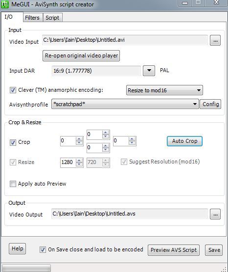

    7) 7) I open MEGUI > Tools>AVS Script Creator.
    8) 8) Import AVI-Signpost via “Video Input>AVISource.
    9) 9) Immediately I get a screen called “AVI Chunk Viewer” which I close several times as it pops up twice.
    10 10) AVISynth Creator opens and I set the following
    1111)Then I get a script error
    1 12)There are no Text files in the log to be seen.
    13 13)The untitled AVS file is below.
    1 14)This sequence of events happens repeatedly,
    15 15) I hope this makes it clearer.

  20. 6) Vegas does not render in the background, it just waits for any application to load and read that signpost.avi, then Vegas proceeds to serve frames from its timeline ti that application through that signpost.avi. Signpost.avi is just a small file, lessthan megabyte or so. If you check "write audio as PCM" then audio gets written at ones into that signpost.avi, so it gets a bit bigger. Not sure if it is necessary to set audio (your #2) if you check that "write audio as PCM" . This is always a good idea to render, if there is more tracks then one or application might not read audio then (like ripbot264)
    9) Get rid of that "Avi chunk viewer" from your system. This is causing you problems. Google that and there is some solutions.
    11) megui generates that script? you chose some tfm ? This is not home video? If this is some movie or TV show, not sure how apropriate it is to use tfm filter, remember your untitled.avi (aignpost.avi) has properties of Vegas project. Debug mode frame server serves Properties settings not clip properties from the timeline. So there might be a problem.
    That error tells you that video needs to be YUV. You have to move your script line that converts from RGB above that line with TFM.
