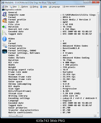

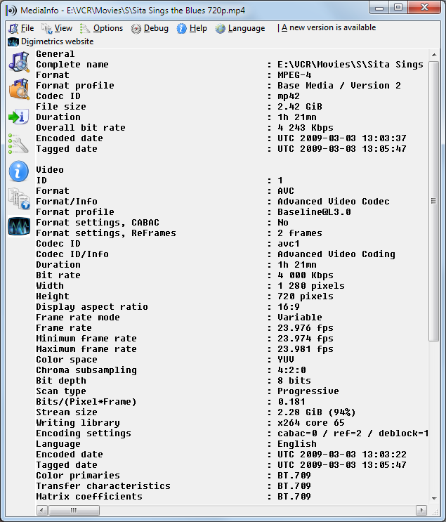

    Yes, it would depend on which encoder was used. x264 (free, open source) stores all it's settings within the file and you can see them with MediaInfo. Other h.264 encoders don't do that. Just to be sure, did you check the original MKV files? The metadata may have been lost on remux to MP4.
    Oh, also be sure to use MediaInfo in View -> Text format. So you see something like:
    Here's an example of the line with the x264 information:
    Encoding settings : cabac=0 / ref=2 / deblock=1:0:0 / analyse=0x1:0x131 / me=umh / subme=6 / psy_rd=1.0:0.0 / mixed_ref=1 / me_range=32 / chroma_me=1 / trellis=0 / 8x8dct=0 / cqm=0 / deadzone=21,11 / chroma_qp_offset=-2 / threads=12 / nr=0 / decimate=1 / mbaff=0 / bframes=0 / keyint=240 / keyint_min=24 / scenecut=40(pre) / rc=2pass / bitrate=4000 / ratetol=1.0 / qcomp=0.60 / qpmin=10 / qpmax=51 / qpstep=4 / cplxblur=20.0 / qblur=0.5 / ip_ratio=1.40 / aq=1:1.00
    Ref and bframes are the ones I mentioned earlier. Some of the others may be a problem too. But I don't know exactly what the Xbox 360's capabilities are.
