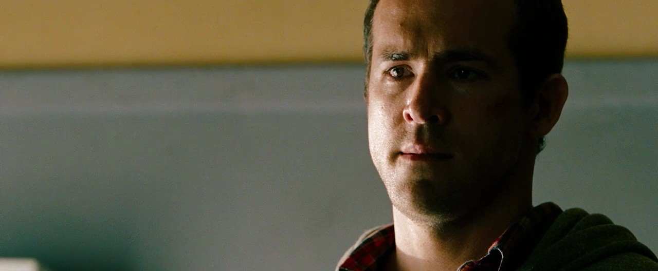

  2. You reduced the bitrate of a grainy source by a factor of 10 and you expect it to look good? A decent 1280x528 encoding that retains the grain:

  4. Originally Posted by jagabo View Post
    Did you mean the caused of the pixelated is from the grainy?
    I played this both on Media Player Classic and MPCStar. Media Player Classic showed the pixelated scene but on MPCStar grainy only and not pixelated
  5. DECEASED
    Jun 2009
    Heaven
    No, he meant grainy sources require higher bitrates to be recompressed without artifacts.
  6. Originally Posted by slarke View Post
    Then you have a player problem. Since we can't see exactly what you are seeing on the screen it's hard to say what might be wrong. What about the video I uploaded? How does that look in the two players?
    It looks fine sir on both players It showing only grainy

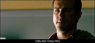

  8. Looking at your encoded 1280x528 video here, I'm not seeing as bad blocking as your JPG sample. I don't know if it's because you saved as JPG with low quality settings. But check your h.264 decoder. Make sure deblocking isn't turned off. Here's what I see (lossless PNG):
    Click on the image a few times to see it full scale.
