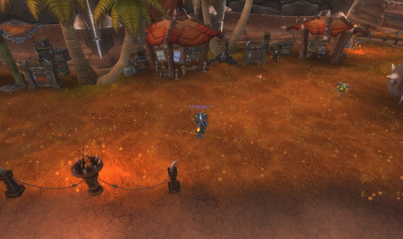

    How the video looks in VLC:

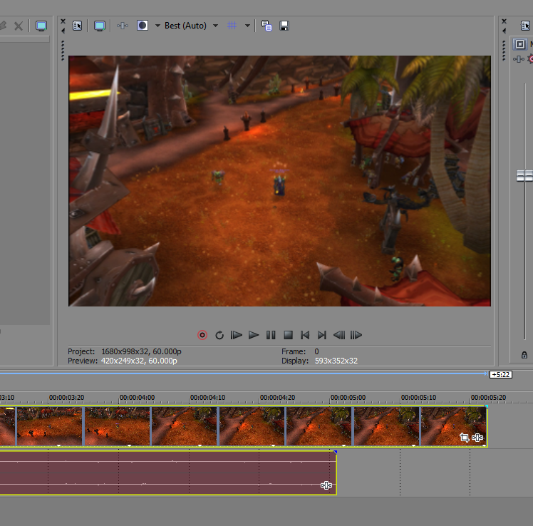

    i had to convert it to mp4 for vegas pro to even open that one. it's a little on the strange side. the width height and dar are all bizarre. once it's mp4 it looks like this and works fine in vegas pro 12. try using avidemux to convert one at your end and see if it helps it play nice in studio. set video to copy, audio to acc - (faac) and the output to mp4 muxer. name the file to be saved as anything.mp4

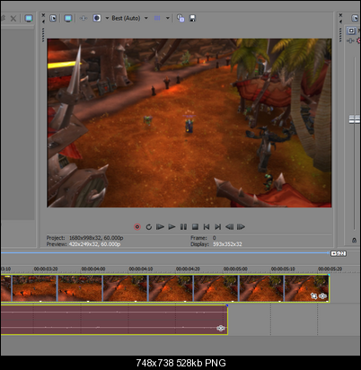

    looks like the audio may be shorter than the video. i used mediacoder to convert the video to huffyuv and left the audio on copy. here's what it looks like in vegas. avidemux may have matched the video to the shorter audio.

    even on the long file you posted the mediainfo of the audio is almost a half second shorter than the video.
