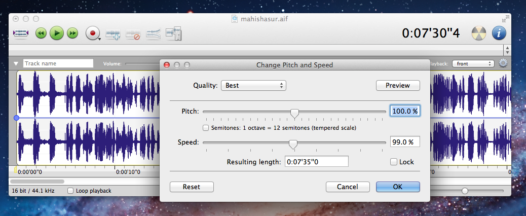

    By film, I meant movie--not 35mm. I have Amadeus Pro which has a change pitch and speed feature that I have found to be extremely useful in the past, since you can change pitch without changing the speed and vice versa.
    I was just hoping there was some program specifically designed for this that would correctly change the audio to the correct length for 29.97fps without me having to manually tinker around until I got a close enough approximation.

    It's worked for me.
    PAL and NTSC copies of the same film, one in english and one in french. Converted the PAL copy to NTSC using MOVIECONVERTOR-STUDIO, extracted the audio and subtitles and then added both to the other film.
