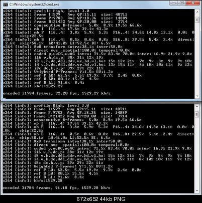

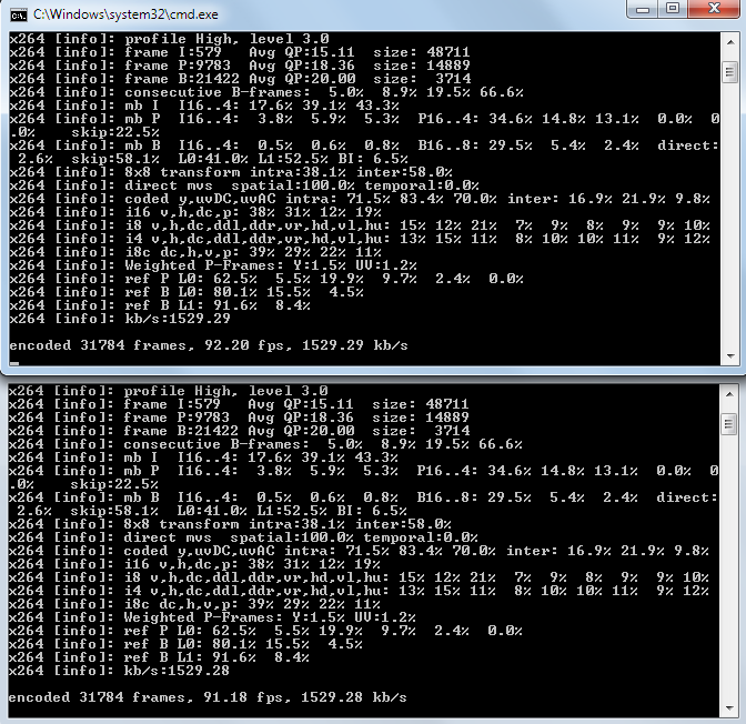

    don't change any settings, make one encode with CRF=18 --qpmax 30 and another encode with CRF=18 --qpmax 50 using the same video source, then compare the bitrate of two ecnodings
  16. --qpmax 30 and 50 will make almost no difference at CRF=18.
  17. just make a try .........i can make a bet on 50% increase upon bitrate
  18. I did. As expected, there was no difference. Both came out at 2367 kbps. When working at CRF=18 hardly any frames will use quantizers over 30.
    On another video (I kept the logs open this time), CRF=18, preset=slow, top qpmax=30, bottom qpmax=50:
