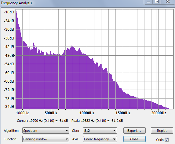

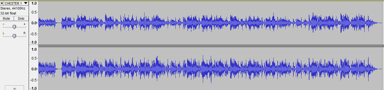

  10. It sounded a little "muddy" to me but that's normal for vinyl to cassette recordings. The graphs below look pretty good for cassette, the drop-off above 10,000Hz is normal. These shots were taken in Audacity so you might try boosting the high end.
