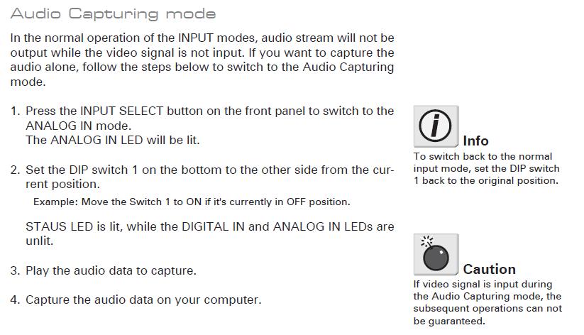

  2. Do below instructions from the user manual help?
