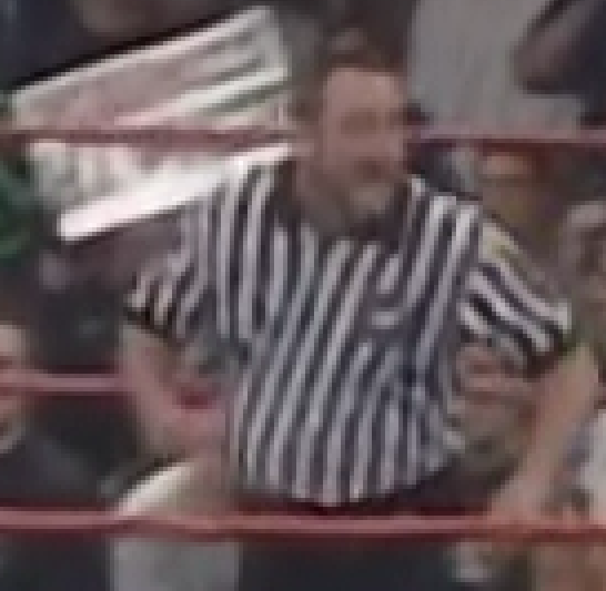

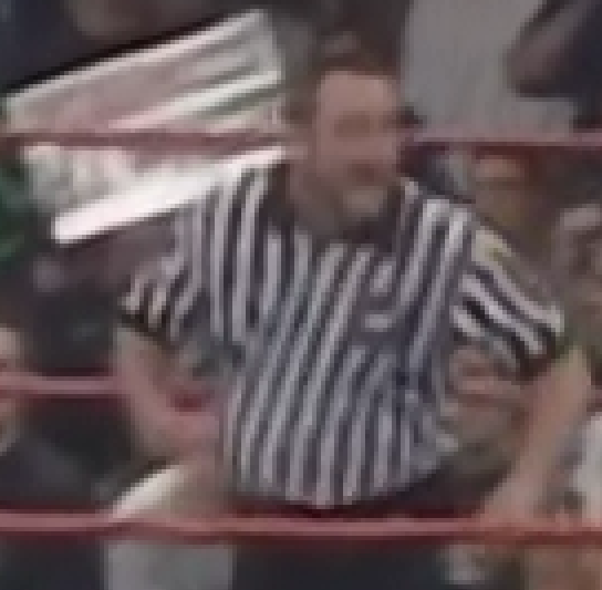

  9. I've updated my 1st post with the information from the closed thread and a sample MPEG2.
    Improving Commercial DVD
    Is there anything else I could use to get a better picture quality? At the moment I'm deblocking and using LSFMod and QTGMC (keeping it interlaced).
    Converting to Progressive

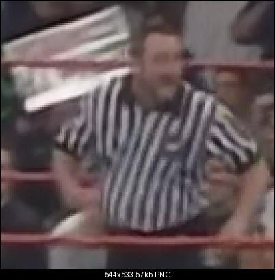

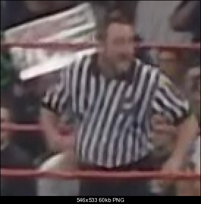

  27. RemoveSpots() after QTGMC() still causes some blurring and artifacting. It's most noticeable on the referee's shirt:
    Before RemoveSpots (4x point resize):
    after RemoveSpots (4x point resize):
    If you interleave the before and after images and zoom in you'll see lots of bluring and loss of detail in the crowd in the background.
    RemoveSpotsMC() was much closer to the original (and still removes spots in spotty videos).
    The truth is though, If you're going to make it back into a DVD, I think you're wasting your time "fixing" this video. The blocks and DCT ringing are going to come back when you encode as MPEG 2. The other problems are minor and you'll lose detail in any attempt to fix them.

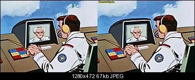

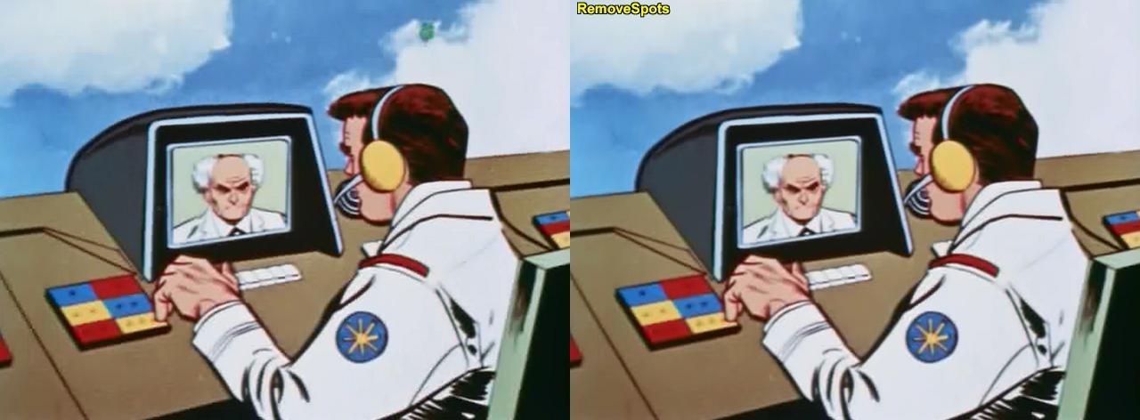

  28. I have just got round to trying it now. Could you please tell me where I can get the RemoveSpotsMC() script?
  29. In the mean time, Here is a few seconds of a spotty video. I noticed an interesting phenomenon. The AddGrainC function seems to cover up the remaining spots that RemoveSpots didn't remove. Please try this script yourself with and without AddGrainC. I can see a clear difference on my 37" TV - AddGrainC covers up more spots! Can anyone explain this? Also if I have RemoveSpots and AddgrainC before McTemporalDenoise then even more spots are removed, however I can't use RemoveSpots while the footage is interlaced because RemoveSpots would then cause blurring.
    setmtmode(5,9)
    Mpeg2Source("H:\video.d2v", CPU=6)
    setmtmode(2,0)
    McTemporalDenoise(settings="medium", interlaced=true)
