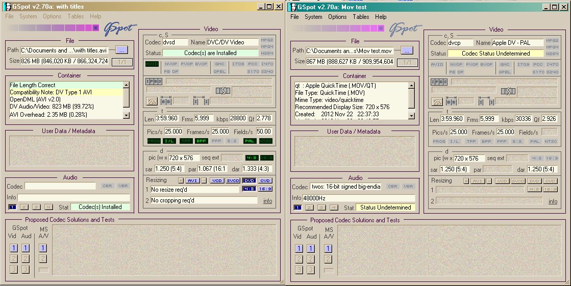

    OK, I seem to be getting there. I've just tried a 4 minute test clip that I had already saved as DV-AVI (although Type 1) and opened it in GSpot. Then I created, using MediaStudio Pro, a DV PAL MOV file from the same clip and the two results are shown below. The only question I have now is how do I reduce the compression rate? If I set compression to DV PAL, it is fixed and quite a bit higher than the 10-15 mbps that they are asking for. No idea if it will make a difference, personally I'd prefer as little compression as possible. Will QTPro or Quicktime 7 Pro (both costing $29) allow me to reduce the compression rate a bit? Fortunately, the finished article will be no more than 22 minutes long so will still fit on a single layer DVD-R.

  5. DV has a fixed bitrate.
    It's obviously a mistake in their submissions instructions (they probably copy-pasted from some other MPEG2 template usded for another purpose and didn't proofread it) .
    Prores422, uncompressed will have more bitrate than what they list as well
    This is obviously a typo as well
    Image size should be 720 x 1080 or if you have full HD capacity- 1920 x 1080 at 25 frames
    It should probably say 1280x720

    This is the part you should use, and PDR is right: DV is fixed at 25Mbps. The bit about 10-15Mbps is a cut-&-paste typo. ProRes 4:2:2 or 8- or 10-bit Uncompressed will all be even larger (uncompressed would be >10 times).
    If you want to quote us when asking again with them, that's ok. I'm sure enough of my figures to stand by them. I'm pretty sure they just want something that is Mac-compatible and something that uses industry standards and is only lightly-compressed (if at all), aka "master" quality.
    BTW, I would strongly recommend you use MediaInfo preferentially to Gspot for describing your media contents. While MI does have its quirks & faults, it is MUCH more accurate and is still being updated (GS stopped ~2007).
