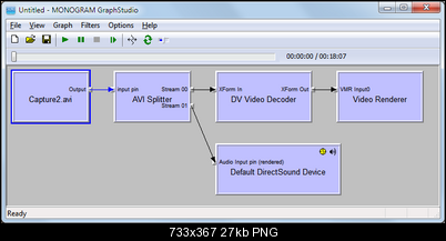

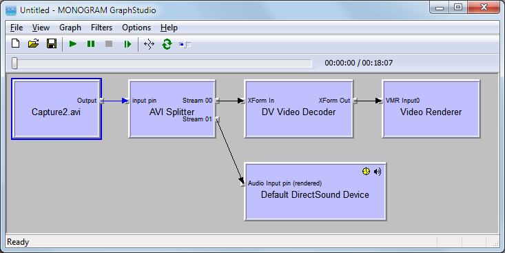

  12. Try installing GraphStudio. Select File -> Render Media File... to build a graph for one of your problematic DV AVI files. What filters are being used? In mine I see:
    You can right click an any of the filters (boxes) and select Properties. In the above graph Capture2.AVI is Windows 7's built in AVI reader (quartz.dll), AVI Splitter is Windows' built in AVI Splitter (quartz.dll), DV Video Decoder is Windows' built in DV decoder (qdv.dll). Press the play button. Does it play past the 4:27 mark?
    I suspect you may have a different AVI file reader or splitter and the problem is there.
