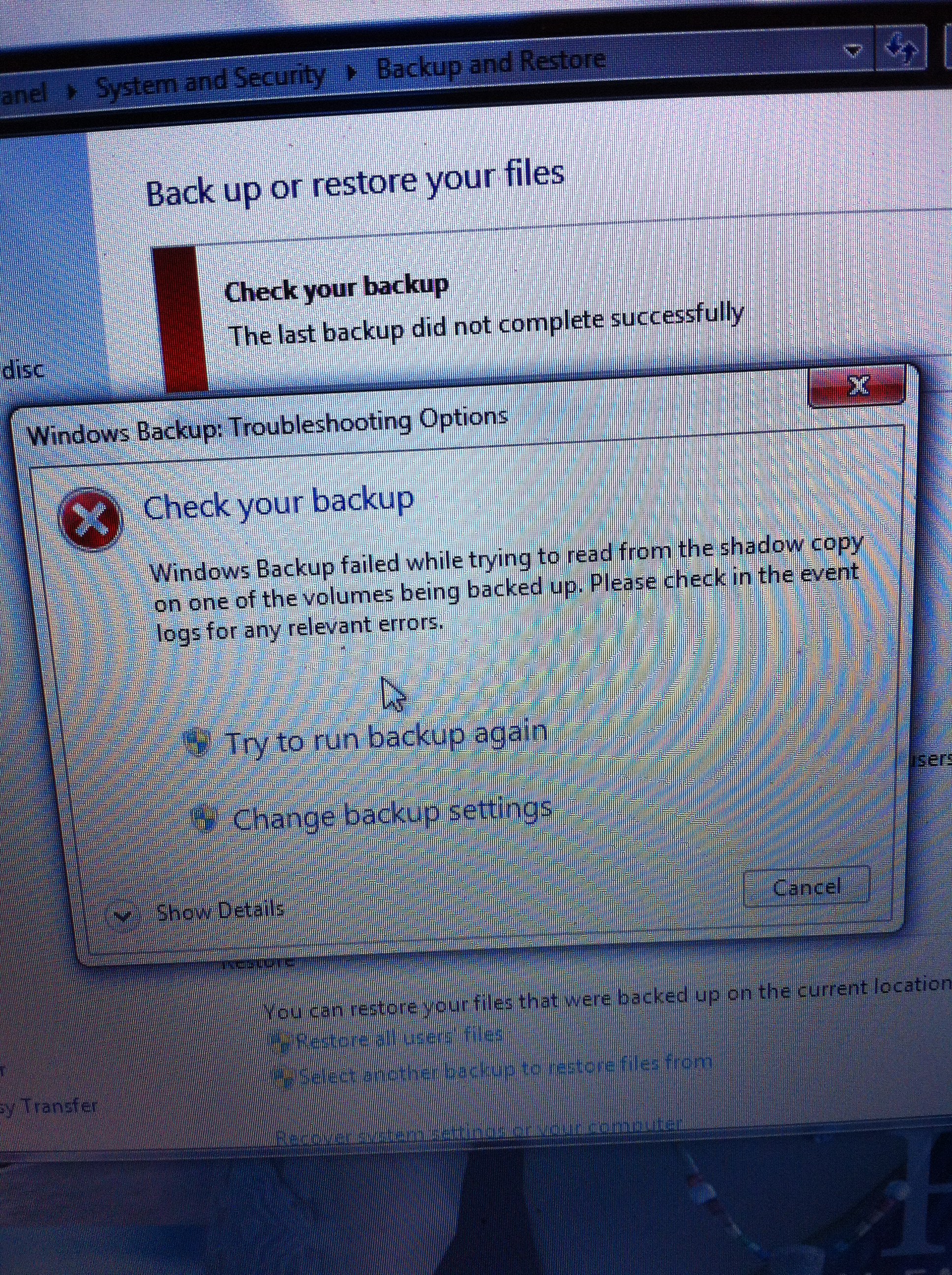

    I was backing up my laptop and after the process was finished, it turned out that the back up was unsuccesful. Here is the image of the error message. What does it mean and what is the solution?

  8. The error message means that the backup failed, that's about it. A flaky hard drive is one possible cause. It does give a "failure to read" error. That could happen to any file on the HD, at any time. The fewer files you copy, the less likely you are to have such an error.

    You're lucky I guess, every time I have used it I get the error in post #6.

    You can get that error (quite recent in fact on a family members PC) when Microsoft Essentials picks up on a Java security hole.
    The History log (of M E) might report something.

    Hi, I tried to do a complete backup including a system image copy of windows 7 but as the process was finished, an error message appeared which says:
    "The system cannot find the file specified. (0x80070002)"
    I checked the size of the backed-up file and it was 110gb while the original OS that I was copying is actually 116 gb.

    Did it name the file?
