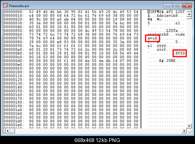

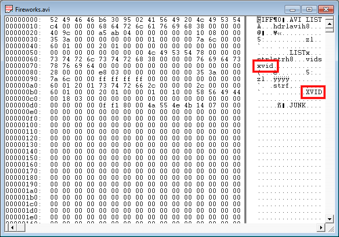

  9. Use a hex editor to change the fourcc to XVID. And the extension should be AVI, not MPG.
    The text in the red boxes originally read N264.

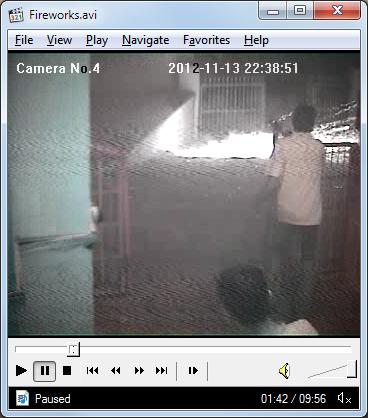

    Oh wow! Thank you Jagabo. It plays just fine now.... Wish I had audio to go with it but I don't think the cameras record sound. This is excellent.
    Thanks again everyone for all the help!

    Playing with fire crackers
    Nov 2012
    Abu Dhabi
    Yeah, that was fun . Luckily there weren't any casualties! I've now added some music and graphics - turned out nice. Thanks again everyone!
