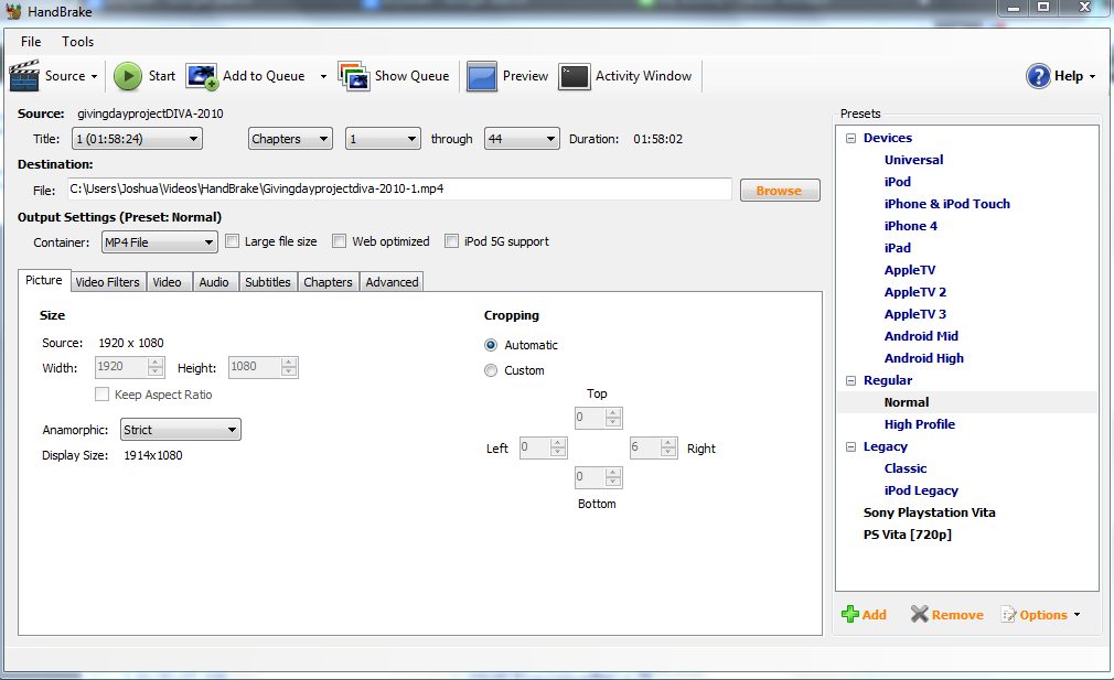

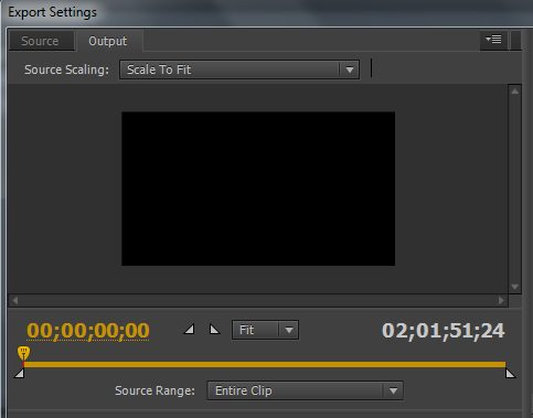

    so basically, adobe i believe increases the duration of the video perhaps because of the VFR. here is a screencap from media encoder showing the time increase, and below it one of Handbrake, which shows now duration increase. got no idea why.
    adobe media encoder
    and
    Handbrake
    i'm concerned if changing from variable, to constant, has any effects to the video/frames that i wouldnt know of.
  7. Originally Posted by Otokonokotron View Post
    It inserts duplicate frames to roughly keep everything in sync. The side effects are it might go in /out of sync very slightly in some sections (the more variable a video, the more issues) , and it's less efficient since you're inserting duplicate (added) frames .And of course re-encoding with a lossy format means you lose quality
    A VFR video is created in the first place by dropping duplicate frames. Compared to the CFR video from which it was derived from, a VFR video will have fewer frames. Timecodes are used to keep everything in sync (the media player speeds up and slows down in sections according to the timecodes) . You're basically trying to reverse that process by adding back in frames in approximately the correct locations (it' s not perfect, hence the slightly in/out of sync issues)
    If you want it "perfect" keep it VFR. You can just use handbrake to do this, or encode it CFR and insert timecodes afterwards.
  8. hmm, yeah, a lot of that seems over my head right now, so, i may end up using handbrake as u suggested. thanks a lot ^^ i'll just have to go learn about timecode more, it seems, if i wanna change it more accurately to a CFR.
