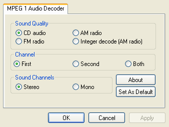

  1. I have an AVI XVID file that will only play the correct audio if I set the DirectVobSub MPEG 1 Audio Decoder (installed with K-Lite Codec Pack) to "First Channel". This file was a recording done with voiceover commentary. The default way that it plays includes a very muffled version of the audio that I'm trying to hear, however when I select "First Channel" via the DirectVobSub MPEG 1 Audio Decoder in the taskbar it plays fine and well.

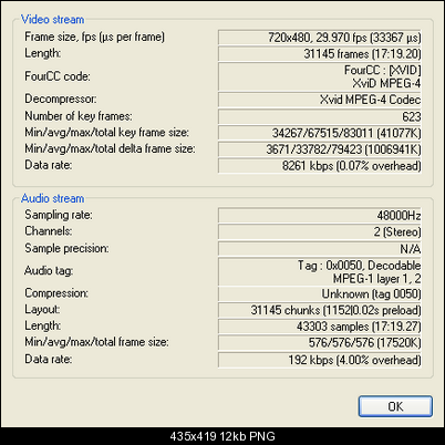

    I've tried a few different shots at converting the file and separating the audio but it always comes out in the "muffled" version. See the VirtualDubMod screenshot for the file information and the DirectVobSub MPEG 1 Audio Decoder settings screenshot. By default the MPEG 1 Audio Decoder setting is set to "Both" channels, however the output this way is the muffled audio. How can I convert this file to play correctly by default? Any help is greatly appreciated.

    Is there 1 audio track, 2 channels (Left and Right) ? Or is it possble there are multiple audio tracks? Use mediainfo (view=>text)

    I don't know what I was referring to when I said "DirectVobSub MPEG-1 Audio Decoder", however (see screenshot) when I mouseover the green arrow in my taskbar it says "DirectVobSub" and that is where I then get the menu option to go to MPEG Audio Decoder. Going there and then selecting "First Channel" is the only way that I have been able to get the correct audio to play from this AVI.
    Maybe someone can explain to me what the difference is between "First Channel", "Second Channel", and how this differs from Stereo Channels left and right. I thought I would be able to go into VirtualDub and select the correct channel or stream and throw out the bad one, but I only see one stream and don't know where to select the correct channel/stream within VirtualDub.

  5. Thank you poisondeathray for the reply. Below is the Audio portion of the MediaInfo view=>text.
    Audio
    Format : MPEG Audio
    Format version : Version 1
    Format profile : Layer 2
    Codec ID : 50
    Duration : 17mn 19s
    Bit rate mode : Constant
    Bit rate : 192 Kbps
    Channel(s) : 2 channels
    Sampling rate : 48.0 KHz
    Compression mode : Lossy
    Stream size : 23.8 MiB (2%)
    Alignment : Aligned on interleaves
    Interleave, duration : 24 ms (0.72 video frame)

    Referring to the screenshot below; default Channel is "Both" and results in muffled audio output, selecting "Second" channel results in no audio output, and selecting "First" channel results in good/desired audio output.
