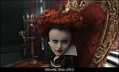

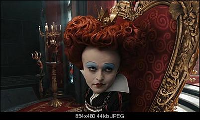

  13. That is the most misguided and ill conceived request I've ever seen here. Why would you want to take a perfectly fine progressive image like this:
    and turn it into an interlaced mess like this (one field shifted left by 2 pixels):
    Click on the images a few times to see them full size.
    [Attachment 14771 - Click to enlarge]
    [Attachment 14772 - Click to enlarge]

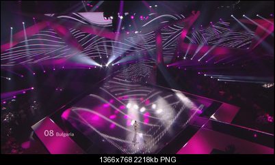

    Wow.. how did you do it?I mean,, was it piece of cake. I wanna learn.
    Right.. now see this:
    Interlaced
    De-Interlaced _Yadif
    De-Interlaced _Bob
    Hmm.. now see what you choice is. Mine is Interlaced. Beside.. it looks bad when you pause video or have much combing like your 2nd picture.

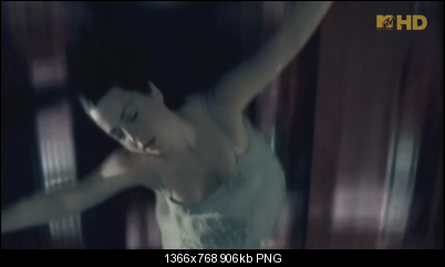

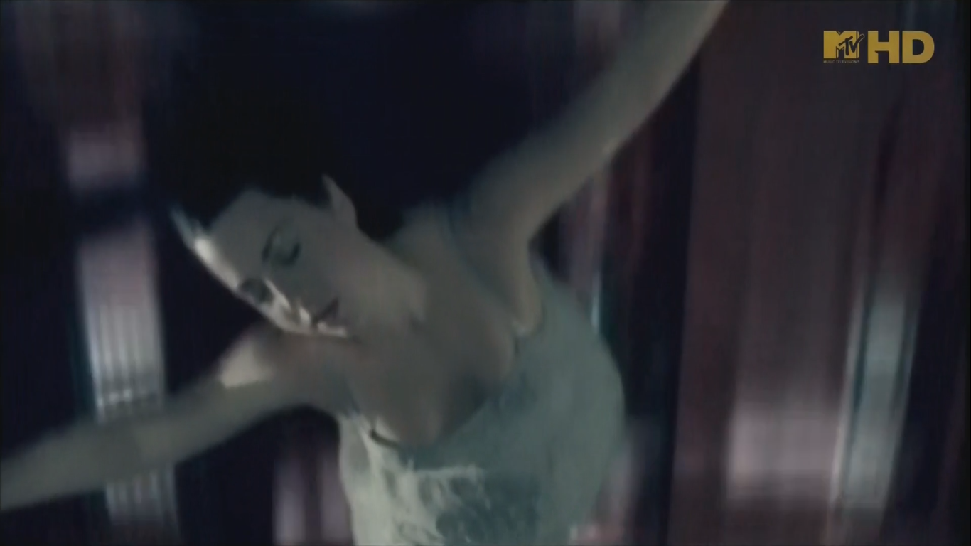

    Ok.. sir,, I've sources like this(Unlike yours) :
