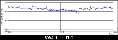

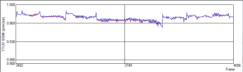

  4. I spent some time recently playing around with MSU's Video Quality Measurement Tool with x264 and have found that settings such as "me_range", "subme" and "me" have very little effect on the visual quality.
    The temptation of course is to set them to "full", but IMHO the loss of encoding speed compared to the negligable gain in quality is just not worth it.
    Below is what I got when I compared two files (720x576 DVD source) with the following settings:
    --me esa --subme 10 --merange 24 --crf 20 --- Speed - 19.5 fps
    --me hex --subme 7 --merange 14 --crf 20 --- Speed - 57.5 fps
Name:	LQ vs HQ.png
    Not much difference there, certainly nothing I could notice with the naked eye.

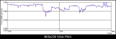

    If we compare the same high quality settings with medium settings with a small hike in --crf.
    --me umh --subme 7 --merange 20 --crf 19.5 --- Speed - 48.0 fps
Name:	HQ vs CRF.png
    This seems to suggest that --crf has much more of an effect on quality than anything else.
    Of course the lower the --crf, the bigger the file size, but the 2.5x speed increase seems like a good trade-off.

  5. mh2360 - can you add the resulting filesizes ? You can't compare "quality" at different bitrates . You either have to do multiple incremental CRF encodes or 2pass bitrate . So at a given bitrate, higher --merange and --subme will yield slightly better quality
    They do make minor differences, but the effect is larger and noticable on very low bitrate encodes . For "typical" scenarios, it's usually not worth it, and especially if you are using CRF (because usually you don't pay as much attention to the filesize or bitrate)
    A larger value for merange can make a bigger difference on HD encodes with lots of action compared to a SD source (but overall it's still very tiny difference)

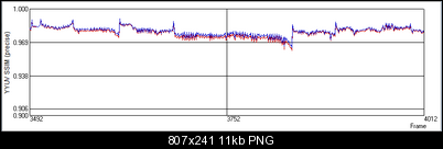

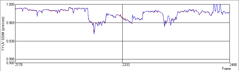

  6. Of course you are correct in saying that you can't compare quality at different bitrates, so I compared another file (The World War Z trailer downscaled to 720x576 if anyone is interested), at a much lower bitrate using 2 passes.
    The settings used for both samples are below.
    --me hex --subme 6 --merange 14  --bitrate 1400 --trellis 0
    --me esa --subme 10 --merange 24  --bitrate 1400 --trellis 2
    1400kbps is below what I would use for a DVD conversion, but there's still very little difference, both visually and according to the chart.
    It could be that I'm using SD sources, and that using higher settings might be more helpful with HD material at lower bitrates.

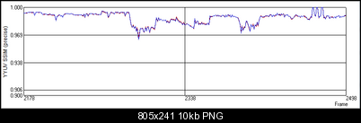

  7. Even when we drop the bitrate to 1000kbps, we see that the average SSIM is dropping, but there's still very little difference between the samples. Visually I can see no difference at all.
    Must do some HD testing...
