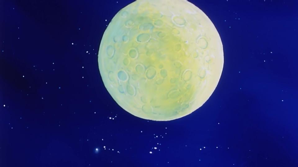

  4. These won't do. There should be a bi-directional frame compensation. I never thought only 3 (even 2) pixels would make a noticeable difference. Observe the top of the moon.
    I guess I will have to crop, but at least I figured out that only the top and left side need cropping. Why is this? Does a video never wobble downward as well as upward?

  5. Well I've pulled an alternative trick out of my sleeve. The top and left borders have no real reason to be blacked out by stab so I replaced them with the borders of the unstabbed original.
    Script:
    s=avisource("C:\vid.avi").stab().crop(2,2,0,0)
    e=avisource("C:\vid.avi")
    top=e.crop(2,0,0,-538)
    left=e.crop(0,0,-958,0)
    f=stackvertical(top,s)
    stackhorizontal(left,f)
    Observe the moon. Way better than the crappy fill filters.
