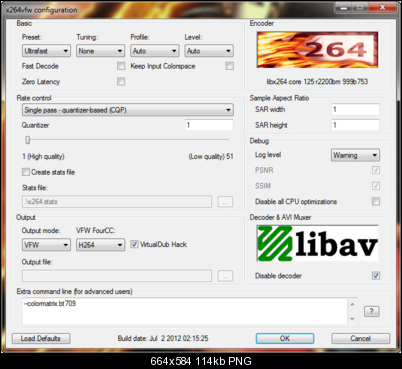

    Load Frpas files in Virtualdub and use Fast Recompress - Video codec: X264VFW / audio: Direct Stream Copy(Look screenshot to config):
    720p FRAPS (22.8GB)
    720p X264 (8.7GB)
    Claudio
