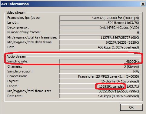

    In the link it says that the duration of the audio equals the number of samples/sample rate
    https://forum.videohelp.com/threads/350864-Demux-audio-from-ntsc-video-and-mux-with-pal...=1#post2200012
    I can't relate that to the numbers in the image below.
    It says that the number of samples is 1019391.
    Dividing 1019391 by 48000 = 21.2, not 63.71 or am I misinterpreting what VirtualDub is reporting.

    Apparently, the meaning of "samples" in the length field has nothing to do with the playback frequency.
  3. It's off by a factor of 3 for some reason. A factor of 2 I could understand since it's stereo. But 3? Must be a bug. I've confirmed that VirtualDub 1.9.11 has that problem with MP3 audio. With stereo PCM it's reporting the right number.
  4. hmm - It's off by different factors on different video/audio samples even on different types of audio (AC3 was misreported as well) . Avisynth's info() seems to report it correctly
    The duration is correct - so I'm not sure if it really is that relevant or important, it's just misreporting the number of audio samples.

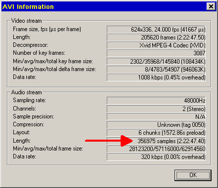

    This case is much worse , and I think the OP should pester Avery Lee himself:
