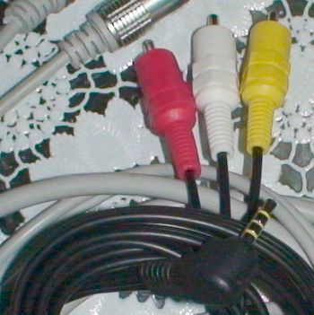

    What is the Sony camcorder name? Your cam should have composite input but a special cable is needed. The end with 3.5 mm jack connector go to cam and from the other end the white and red is for audio input and the yellow is for composite.
    Image Attached Images

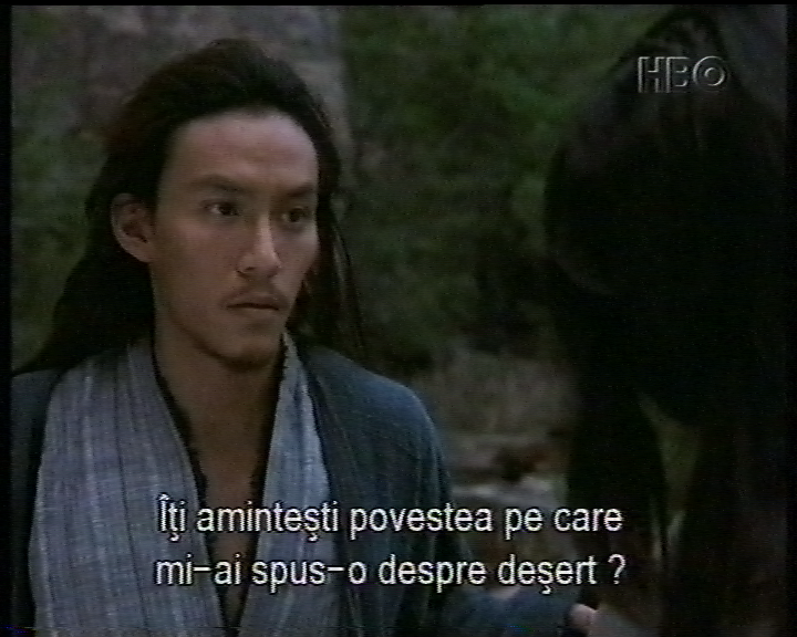

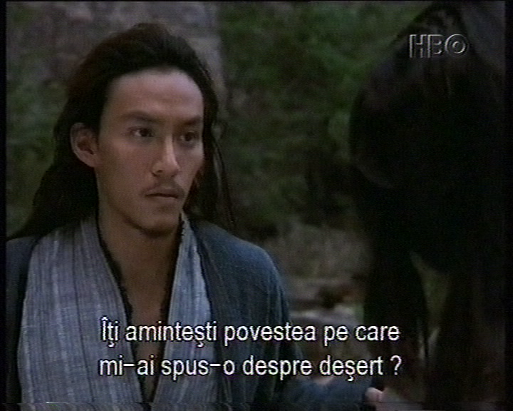

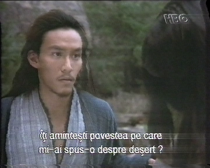

    I tried to replicate your problem and with my Canon MiniDV camcorder. Here are the results:
    first image: from regular VHS (no S-Video connector) force composite in S-Video input from camcorder. The AGC fail to set level correctly and the times base errors are exacerbated.
    second image: from vcr to Canon cam composite input. The comb filter from Canon camcorder is is a bit beter than Sony.
    third image: captured by capture card with 3D comb filter

    Not bad. Only problem: bottom two images have crushed darks, no detail at all in shadows or hair. Watch those AGC's, they can ruin video levels and it can't be fixed.
    The problem is on the tape. There's no detail in the hair in the lighter cap either. And the blacks are in the low single digits in RGB so any necessary adjustments can be made while the video is in YUV with no additional detail loss.
    And why bother even mentioning it when the OP's issue is dot crawl, not levels.
