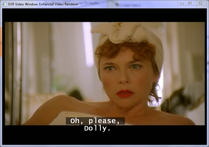

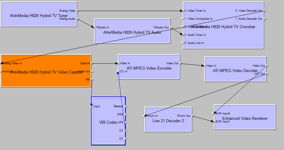

    I created a Graph in GraphEdit and I can see Closed Caption with it. See the attached screen captures.
    But it does not allow me to link CC from "VBI Codec" to "MainConcept MPEG-2 Video Encoder"
    Otherwise I would be able to record CC into MPEG after the encoder.
    Is there a way to record the CC?
    Thanks very much for any help or info.

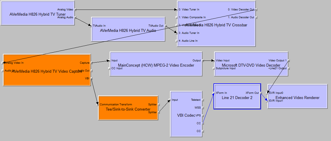

    I think the MainConcept MPEG-2 Video Encoder filter is just a jerk.

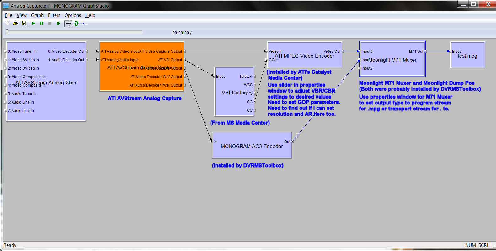

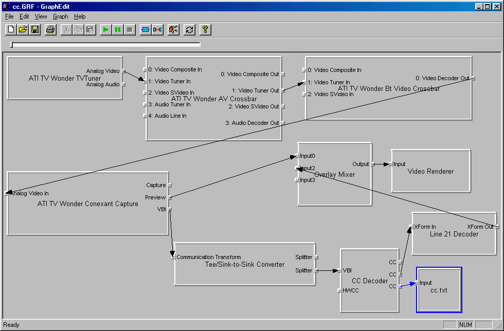

    Here is an example of a working graph using an ATI card, thanks to unusually_quiet for the image. Maybe you can install the ATI Catalyst software even without the card in order to get the codec.
Name:	Diamond 650 S-Video Capture Graph.jpg

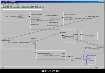

    And here is an example from the SCC_TOOLS documentation showing an example of recording the closed captions to a separate file rather than embedded by the MPEG-2 encoder.

    vaporeon800: One of my computers has ATI TV Tuner, so I already have the encoder.
    I will try and report back.
    Edit: Working! Thanks!
