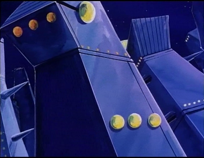

  1. So I have an HD and SD version, one 4:3 one 16:9. The SD video seems cropped on the sides as proven by the HD version, but the HD version is vertically cropped to make it widescreen.
    I wanna combine the top and bottom crops of the SD video to mitigate the unnecessary crops, but I wanna know how realistic this is, because I can't align the SD frame properly and even then there will be empty space in the top right and bottom right corners, which are small and may or may not be easily filled in with some extrapolation tool like Region Remove.
    And then there still would be color/brightness/contrast correction because the SD video is darker etc.
    Here are the frames. Should I dream on or what?

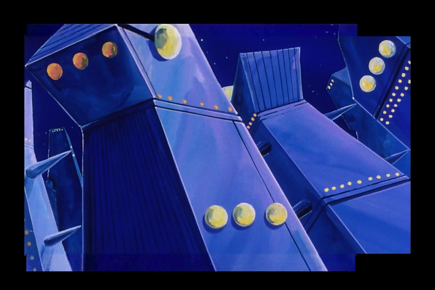

  4. This is just a rough idea of what is missing from the HD version
    I just manually resized the width, height disproportionately of the top and bottom and position it to "fit" in after effects. It can be done in any NLE, photoshop, etc... . If you spend time on it you can probably get it to match up better in terms of fit and color, I just quickly brightened it with curves. Then you could crop and resize to 1280x720 . Maybe use content aware fill or impainting filters on the top right and bottom right corners
    Notice the SD version is missing vertical dark lines on the bottom , but has the horizontal lines on the top. It makes you wonder what else is missing in other scenes. Probably not worth it IMO

  5. How can you scale it unevenly and get it to match? I spent an hour with GIMP re-scaling and overlaying over the other picture with 50% transparency and couldn't match it perfectly. It seems the frame is a bit warped. Of course, I locked the aspect ratio while scaling.
    Can you tell me the width and height of the SD frame? I was thinking of stacking the tops and bottoms with avisynth and fixing the borders and right corners with Region Remove vdub filter.
    Does After Effects have content-aware fill for video? I'll download and install AE if it does. Is there a free version? I used AE once or twice in the past for a quick fix then uninstalled so a demo version might detect the old installation and refuse to run.

    Like you said, the frame is warped. And I said "disproportionately" above - so that means unlock the aspect ratio scaling. I just "eyeballed" it until it approximately fit. I did the top and bottom separately. The numbers used w:h (from your jpg) were 156%,152% for the top section, 155%,154% for the bottom section. Note I scaled from the center point. You might have scaled off center for perhaps a better fit - there is evidence that this would actually work better (things weren't processed evenly somewhere along the line)
    To blend the demarcation line, you can apply a vertical blur through a feathered mask
    I didn't spend much time on the color (You can do a much better job matching) , I just made a quick curves adjustment
    No it doesn't. You would batch process photoshop or other content fill software. Even avisynth has inpainting filters like avs inpaint . There are several logo removal filters that use inpainting as well
