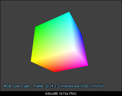

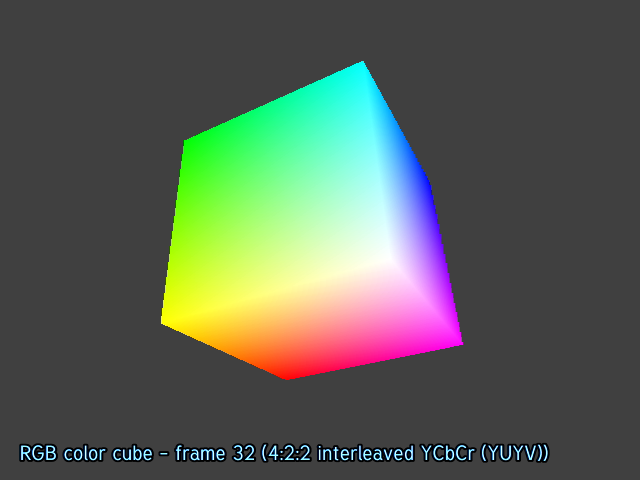

  5. Gif uses a 256 color palette. It's not going to look good unless you have few colors and an optimized palette. VirtualDub uses a generalized palette of 256 colors spread across the full 16 million color RGB cube. That means the steps from one shade to the next are very large.
    full color original:
    256 color GIF:
