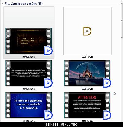

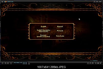

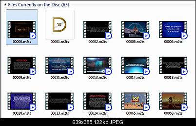

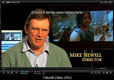

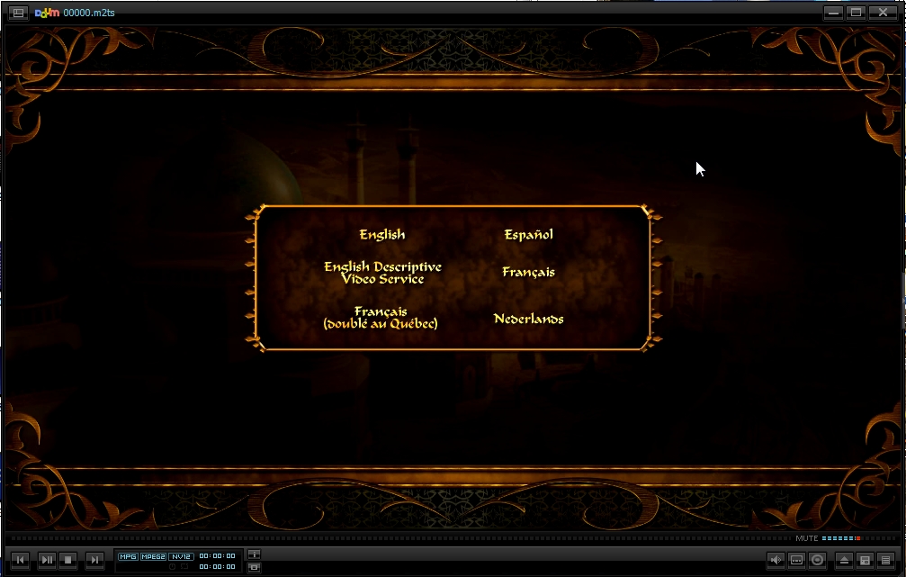

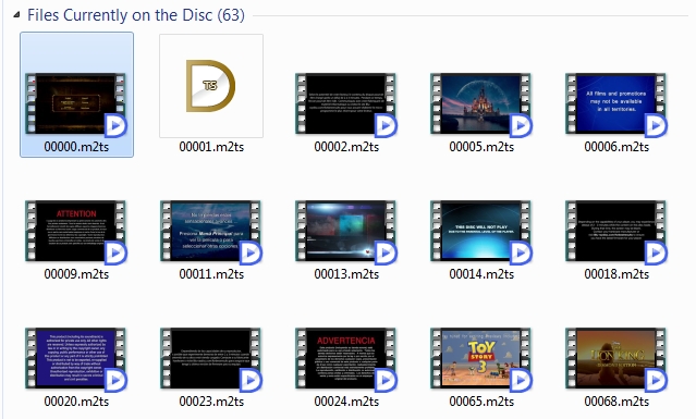

    Best I can do is give you my experience with Prince of Persia. I opened Price of Persia Blu-Ray and activated AnyDVD. Under the Blu-Ray structure F:\BDMV\STREAM I found all the M2TS files. From My experience in the past, The largest file sized M2TS is the main movie and Usually the next largest is the special feature such as "Making of the Film', etc. My Potplayer was not able to play all the M2TS files nor give me a Thumbnail so I added the LAV splitter and video decoder and set MPEG-TS to use them. INSTANT Thumbnail. Seems the first 0000.M2TS is the menu but it is not selectable within PotPlayer. The Thumbnails DO give you a fairly good indication of what is what.
