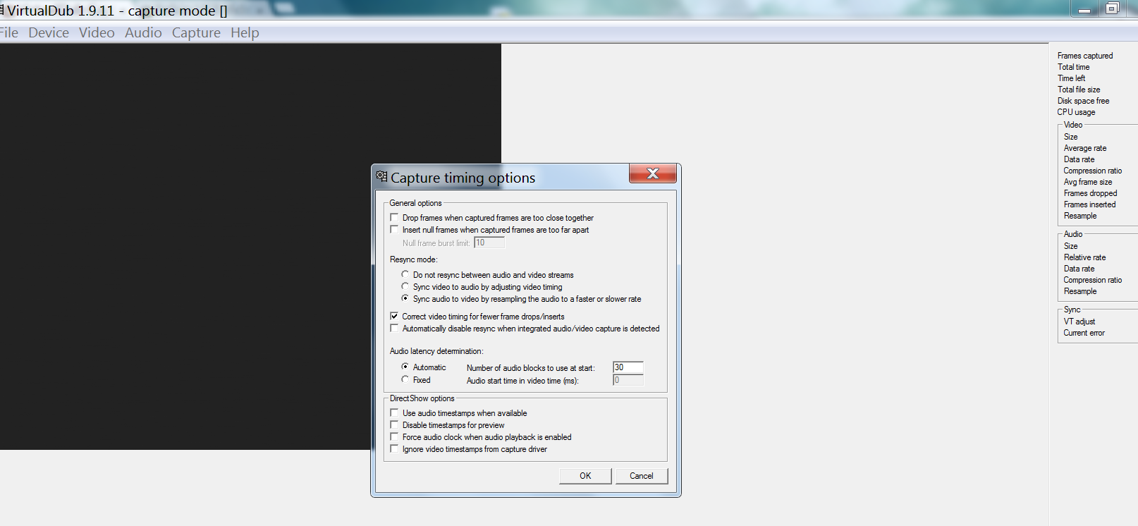

Fifth in virtual dub there is setting ( picture bellow) "timing" where you can try different settings to see what gives you better results.

HI, thanks for the quick reply! I went into Capture Timing Options and noticed Resync Mode was set for Sync audio to video... As soon as I changed it to one of the other settings (Do not resync... or Sync video to audio...), the speeding up problem stopped! I'm still not sure which of those are best, but I left it on Do not resync... so I can concentrate on getting the other settings right without Vdub doing any resyncing.
Now the only problem is that the video is consistently behind the audio. I've tried a few different Audio Latency Determination settings (Automatic > Number of audio blocks... 0 - 120, Fixed > Audio start time... -500 - 500) but none of them seem to make the audio later to match the video (which may be because I'm having video latency, not audio). I'm guessing I could reopen the captured file and resync the audio, but I'd rather get it right in the capture stage, if possible. Any suggestions here? -
Kind of answering my own question here -- I read up on the Audio Latency Determination function and I don't think it can be used to change the position of audio to video, or at least I couldn't get it to. So, I wound up setting it back to the default setting Number of audio blocks... 30, captured the file as-is, then reopened it, and used Audio > interleaving > Audio skew correction > Delay audio track by 350 MS, and the result is as close to perfect as I can get! Stays in sync the whole song too.
