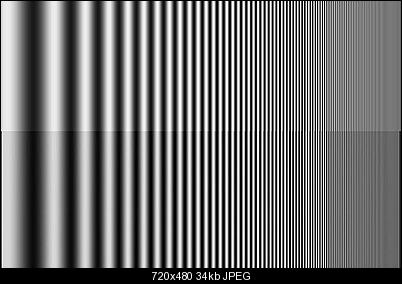

    In my experience, DVD players don't crop the frame when putting out an analog signal. If you have a studio monitor which doesn't overscan and shows the front and back porch you will see the full 720 pixel wide frame. It's just that the inner 704 pixels conform to the ITU spec for the 4:3 DAR image. Here's an example:
    The top half of the frame is from the test DVD. The bottom half is what was captured from the player by a capture card on a PC. You can see that only a pixel or two is missing in the bottom half.
