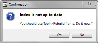

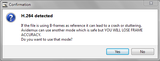

  1. I am trying to hardsub to an mkv using avidemux. I am using avidemux version 2.5.5 since it is the latest version that includes the subtitle option. I open the original mkv file and receive the following message, see picture 1. I click no and the second dialog box opens, see picture 2. I choose yes and it opens the video. For my video option I choose MPEG-4 AVC and I choose copy for audio. I leave the encode mode on Constant Rate Factor (single pass). I then add the ASS subtitle filter along with my subtitle file. I choose MKV as my format and save it. When the process is finished I end up with a longer file than the original and the audio is out of sync with the video, but the subtitles are burned in. I ran the original file and the new file through mediainfo. I noticed several differences that seem like they are important and then there are several of less importance like the names of tracks, etc. The results of the media info scans are below. It seems like an issue that happnes with mpeg audio and that Builiding a VBR time map would help, but the audio is aac. I also don't know how to install MAD (mpeg audio decoder) so that Avidemux can build the time map. So I can't even try it.
    Picture 1:

    Picture 2:

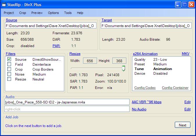

  10. Yes, they are indeed burned in. I guess I'll give it one more go. Can you give me specific instructions on how you did it? I'm not really sure what you did.
    Mar 2008
    See if this is file is how it should be (it's 77MB) :
  12. Yup, you got it. Can you leave some instructions for how to do it.
    Mar 2008

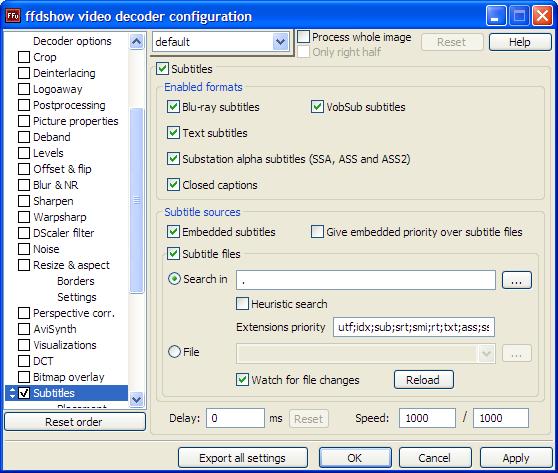

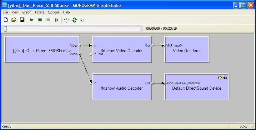

    I used Staxrip 1172. I mentioned the process at a high level, but I'll fill in some details.
    Install Staxrip. If you see any errors concerning DGdecNV or DGindexNV, see the comment by arto65 on this page.
    http://www.techsupportalert.com/best-free-video-encoder.htm
    Uninstall or deactivate vobsub if present.
    Render the source file with Graphstudio and confirm that FFDshow is the decoder.
    Turn on FFdshow's subtitles.
    Open Staxrip and under "Filters", deselect all except "source". Right click "source" and choose directshowsource.
    Click on "source" (top left) and load your file. On the right where it says "divx plus", (above the white box- right)
    click it and choose your x264 profile (I used x264 animation). Set up your audio .
    On the bottom right where it defaults to aac 96 vbr, you can click that and
    set to "just mux" if you'd like to use the original audio. That's all. Hit "next" and "start"
