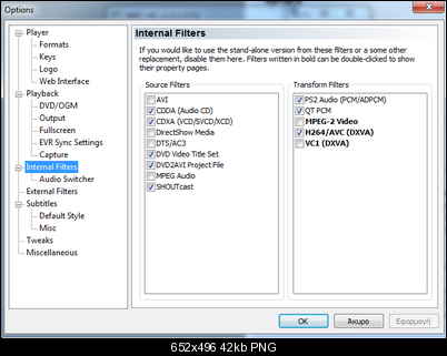

    Try mpchc.
    If you are already using it you can try disable the built in vc1 or mpeg2 decoder, view->options and internal filters, unselect mpeg2-video/mpeg2-video (dxva) and vc1-decoder. Some blu-ray are in vc1 or mpeg2 instead of h264. And let ffdshow decode it.

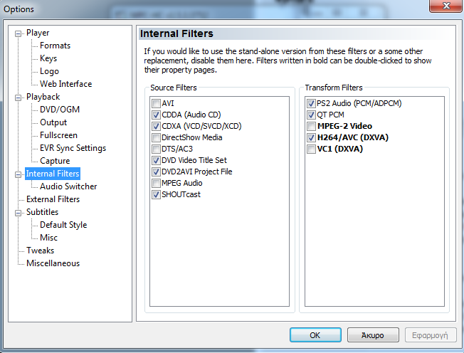

  5. This is what i got:
    VC1 is deselected. So, I should deselect H264 too?
    edit: I tried deselecting it, and it didn't do anything. the same problems.
