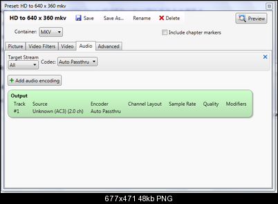

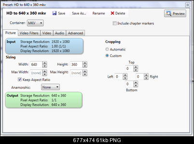

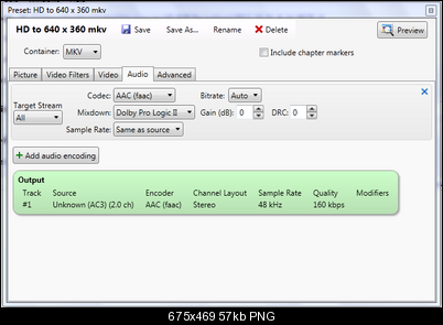

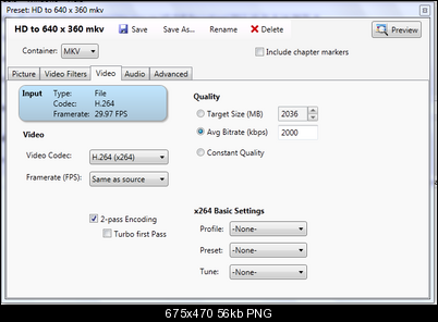

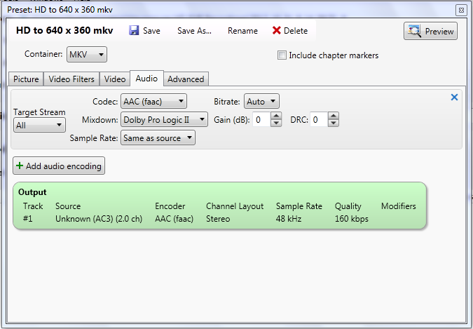

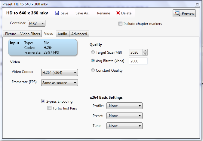

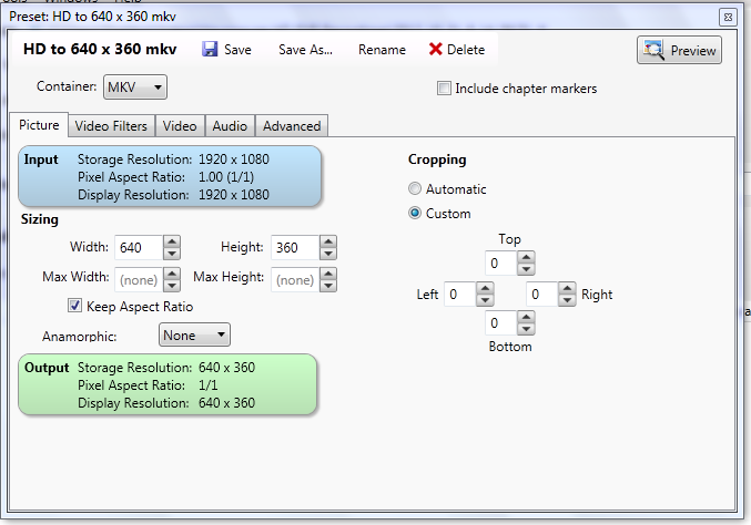

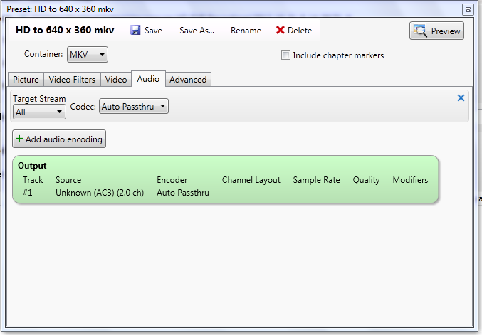

  1. I decided not to go the route of putting my Hauppauge HD-PVR recordings onto Blu Ray discs; instead deciding on encoding them to a smaller file size. I have been editing the videos with VideoReDo. Well I decided I wanted to use Vidcoder for my encoder. I chose the .mkv container with the .h264 codec. I have included some screenshots of the settings I have used to get the desired file I wanted. I only have a small 17 inch monitor and the biggest display I have tested so far is a 20 inch 480p HDTV; but the files look and sound good. I did make a mistake with the audio settings, and didn't realize it until today while doing the screen captures. The original audio on my files have ac3 audio and I wanted to pass that through without re-coding. But it turns out I chose the aac pass through instead. I have corrected that and I will be testing out the correct audio pass through this afternoon. These are true HD Widescreen files, so no cropping was necessary. Take a look at the Picture Tab settings that I took a screen capture of for the cropping and other settings. Here are the screen capture pictures:

    I chose 2000 kbs as my bit rate for video and 2 pass encoding. I may experiment with a lower bit rate. Perhaps someone can give me some advice on that. Perhaps someone who has a bigger screen will use these settings and let me know how the file looks on their television screen. I am saving up for a 32 inch HDTV that will be my monitor and TV screen. I thought perhaps these settings would be of some use to someone. I will share settings for converting a pillboxed widescreen non HD 1920 x 1080 video to the 640 x 360 .mkv file encoded with Vidcoder soon. I am still trying to figure out a 4:3 pillaboxed non HD or HD as well 1920 x 1080 file; when I get those settings figured out, I will share them.

  3. aedipuss: I will keep that in mind and perhaps do a bit more experimenting. I remember encoding some video that had two audio tracks and a one pass encode didn't include the audio and perhaps the subtitles as well. It has been awhile since that encode and the memory grows fuzzy after awhile. I do remember doing a two pass encode and everything showed up, but that wasn't a capture file it was a backup. Thanks for your input.

  5. 2000 kbps is probably twice as much as you need for a 640x360 video. If you use Constant Quality encoding you'll always get the "right" bitrate for the quality level you specify. You won't have to guess.
    Whether or not multiple audio tracks and subtitles are retained has nothing to do with whether you use single pass or multiple pass encoding.
  6. jagabo: Thank you for your advice. I did some research and I found out that the 720p HD is 1280 x 720p. So I am going to try that new size with a constant quality of 18. I will do a test encode and see how it works and report back.
  7. I just watched a bit of the encode that Vidcoder processed with the 720p settings with a constant quality of 18. It looks and sounds spectacular. It took only about 38 minutes to encode 86 minutes worth of video AVCHD footage. The file size is 1.87 GB. I think that is a reasonable file size for the quality.
    jagabo: I always thought there was a quality advantage to 2 pass encoding at a constant bit rate and thanks to your advice and that of aedipuss, I have tried the constant quality and I am pleased with the video and audio quality and the saving of time is an added bonus.
