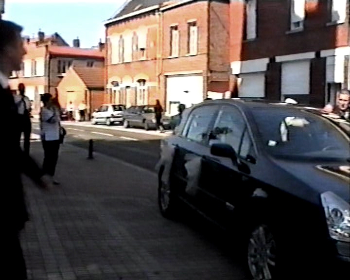

    I attemp to acquire old family VHS with an ATI TV wonder 600 PCI.
    I use composite input.
    I capture in 720*576 , I use picvideo compression and lame MP3 , I use virtualdub capture
    I have no drop frame
    When I use the same cable on the TV (CRT or LCD) all is ok.
    When I Capture I have very strange HUE variation.
    The start time is always in the same time but it's for sometime 1 seconde, sometime 10 seconde.
    As you see in the picture , there is the problem in the same scene .
    On the first picture you see the scene with normal color, on the second picture, 1 second later hue is bad....
    On virtualDub with hue/saturation/intensity I can adujust picture (hue -99,sat 0.84) and obtain the normal image but it's a very long job to apply filter on 1 to 10 second in 2 to 20 time per minute.
    Where this Hue probleme could come from ? ATI card ? ati drivers ?
    since the problem is not on the tv and is for all my VHS, i think the is no probleme with the VHS or the VCR.
    Thanks for your help.

  8. The U channel is being copied to the V channel. So instead of YUV you have YUU during those shots. You can get the bricks back to their normal color with a hue change but some other colors will still be wrong. You need to fix the capture process to prevent the problem.
  9. Banned
    New York, US
    Say, some ingenious insight, jagabo. You're obviously correct, but how does that bluish U channel copy occur? (rhetorical question, I guess). Certainly makes sense; if most red is wiped out it also kills yellow.
  10. If you run this script you'll see that you can create the bad colors from the good image:
    ImageSource("0003.jpg")
    ConvertToYV12()
    U = UtoY()
    YtoUV(U, U, last)
    I suspect the circuit that separates U and V is getting confused by a weak or distorted signal.

    There's one other possiblity: the V channel is inverted. The fact that there's really only two colors in the image (orange bricks, cyan reflection on the car) makes it hard tell which the problem is. But I'm thinking now an inverted V channel is more likely:
    ConvertToYV12()
    U = UtoY()
    V = VtoY().Invert()
    YtoUV(U, V, last)
    Find a shot with a wider variety of colors and see if you can fix it with this script. If so, you may not need any more hardware. It will just be tedious.
