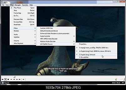

    Use Mediainfo to see what it says about your finished file. It should list the subtitles if they are included. If they are, then they may need to be turned on in MPC-HC in the filters area:
Name:	ScreenHunter_281 Nov. 06 23.23.jpg
    Some types of subtitles need to be selected this way, at least on my MPC-HC, while others play normally by default. This example shows LAV since my computer is using the LAV Splitter but the Haali filter is similar in setup.

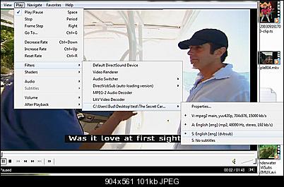

    Might want to Try MPC-HC instead since it has more features but, if you like MPC best, I installed MPC and turned on subtitles in same way but slightly different place:
    Do you have DirectVOBSub installed? It allows most subtitles to be played automatically if included in file or such as SRT, SSA, or ASS if named the same and placed in same folder with the video. Not sure if it's needed by MPC for S_vobsubs or not but I do have it installed on my machine and subs play in Windows Media player, MPC and MPC-HC, MOST automatic but some need to be turned on depending on type and encoding.
