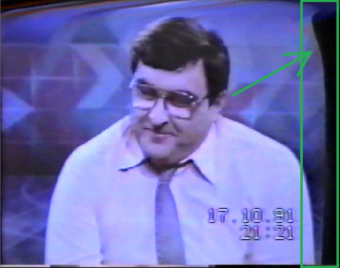

    I have this problem:
    Video example:
    https://forum.videohelp.com/attachment.php?attachmentid=14605&stc=1&d=1352232822
    How do i fix it?
    Thanks for the helpers

    You need a TBC. Others can suggest ones for you. I don't keep up with specific models because I have a video capture card with a TBC that can handle this issue.

    It's called ripping (and sometimes "tearing", as to tear the top from a sheet of paper), or flagging. A line tbc or tbc pass-thru is required, as well as a good player. Often a full-frame TBC is also required in the circuit. Several samples are posted here using a DVD player for tbc pass-thru:
    https://forum.videohelp.com/threads/331681-s-video-artifacts?p=2141386&viewfull=1#post2141386

    The accurate technical video term is actually "tearing".
    It is often fixed by an internal JVC/Panasonic S-VHS VCR TBC, but not always.
    One of the only fool-proof fixes to date is by way of the Panasonic ES10 in passthrough.
    So what does this mean?
    Need to buy a hardware device for that?
    If so then I'm not going for it because this problem occurs about one minute in the tape..
    I want to know - i can fix it without a hardware device? With an algorithm?
    If not then leave it ..
    Thank you

    You can't fix it with software. If it's on the original tape, you need a line level tbc or DVD plsyer as tbc pass-thru. If it has been encoded to MPG or other digital format, it's there forever.
    A little disappointing .. But at least it happens only for a minute so not too bad ..
    But I think there is a way that a algorithm know how to identify and correct the problem.
    I had an idea ..
    But it must be very difficult to program (and I really can not do it) ..
  11. There have been a few people who have made attempts at solving it with software, but to my knowledge, none have been successful.

    I thought the algorithm can correct the problem by this:
    The algorithm will stretch the image to get to a straight black line ..
  13. Interesting approach. Well, if you're trying to write an algorithm that would solve this specific problem for this specific clip, it might be possible depending on the footage, but not in terms of a general solution.
    Looking at this clip, I don't think it would even work for that. What do you do with the top of the frame, especially when the camera comes in for a close-up? You'd end up with a mess. I think your playback deck has some issues too, how do other home recorded tapes play?
    This is an 'at playback' signal problem that can be fixed 100% at playback and without any stretching of the image. You can pick up a Panasonic ES-10 for between $50 and $100 on eBay, that'd probably be the best bet if you're not interested in another VCR. I'm sure there is someone willing with that piece of equipment that could do it for you for less than that as well.
