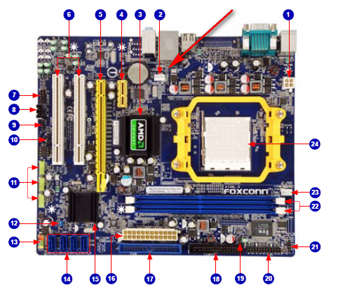

    I will try and plug the case fans into the m.b but I don't really know where I could put them as currently it has it's own panel where I could change the speed it goes at.. then a wire comes from the panel and connects to a bunch of other wires and goes up to PWR2

    the red arrow points to the fan header. white 4 pin connector on the board.
