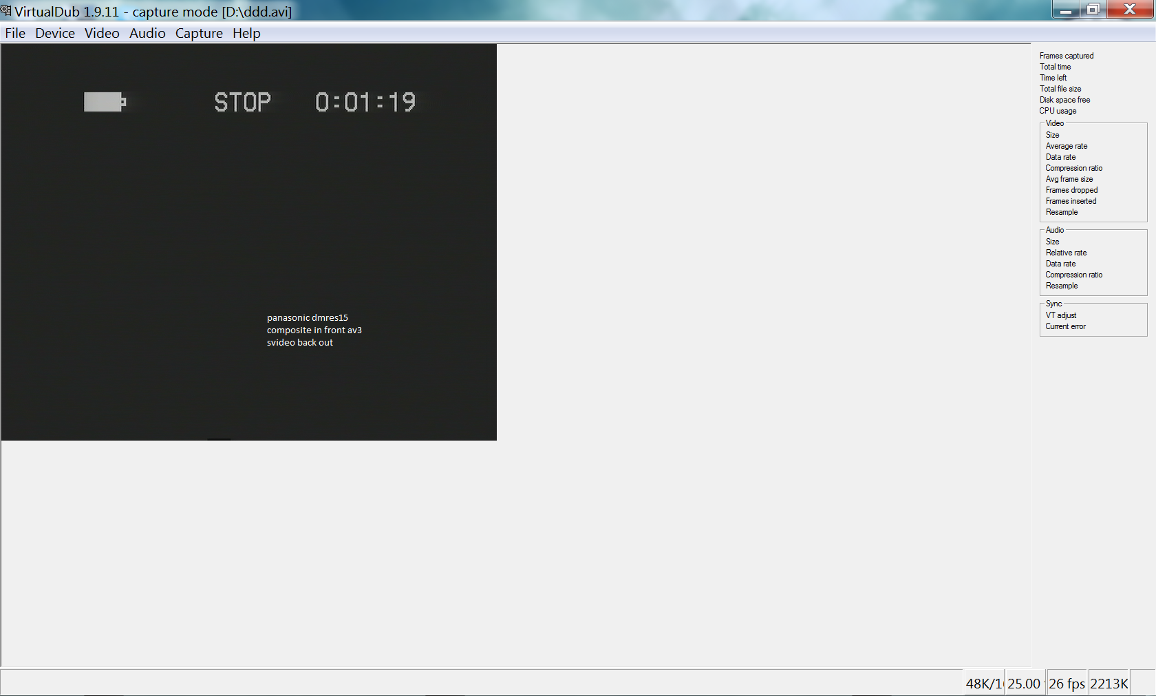

    I tried to use mu 2 shvs players ( ag1980 european model fs200 and only european model hs1000) to be pass trough 3dcomb filter as i heard that they have very good one and only in this units.
    I usually use panasonic dvd recorder ( dmr es15, es10, e60) as comb filter one so i made some test's and they came very very disappointing.
    1.Could it be that the comb filter only works at moving pictures?
    2. Could it be that my vcr's are broken ?
    3. Although not 3dcomb is it possible that dvd recorder has better composite in/ svhs out routine ?
    4. Is it posible that my tv card aver media satellite trinity has some sort of 3dcomb filter ( i couldn't find it on the site http://www.avermedia.com/product/ProductDetail.aspx?Id=463 )?
    The test is done on stop tape
    The source is hi8 camera ( analog composite out )to
    1. svhs composite in svideo out to panasonic dmres15 from there svideo out ( at back) to pc card
    2. panasonic dmres15 from there svideo out ( back) to pc card
    1. No. It is always ON on composite input
    2. No. Are OK but both vcr are very old and the comb filter it also old
    3. Panasonic DVD recorders based on own Matsushita chip have adaptive 2D comb filter
    4. Is it posible that my tv card aver media satellite trinity has some sort of 3dcomb filter ( i couldn't find it on the site http://www.avermedia.com/product/Pro...il.aspx?Id=463 )?
    4. No 3D comb filter on Aver Media Satellite Trinity. The comb filter is an adaptive 2D type with 2 line for NTSC and 4 line for PAL sources.
  3. Your SVHS decks probably only have 2d comb filters. 3d comb filters require enough memory to store multiple frames of video. 3d comb filters work best on stationary parts of the picture.
  4. 2. Could it be that my vcr's are broken ?
    Your SVHS decks probably only have 2d comb filters. 3d comb filters require enough memory to store multiple frames of digital video. 3d comb filters work best on stationary parts of the picture.
    I thought that ag1980 ( hs1000 is even newer model ) svhs has 3d comb filter at least that what i was reading on this forum.
    But why the picture is so terrible on both vcr's and very clean and no rainbows on dvd recorder ( if in theory the dvd should have less effective comb filter).
    More interesting is that if i put the composite directly in tv card the picture is without rainbows ( like trough the dvd recorder one but without the clean edges and without frame sync ability so on bad tapes it drops frames while trough dvd this never happens) clean and much much better than trough vcr composite in svhs out ( comb filter ).
    I am puzzled
    May 2007
    Romania
    AFAIK there is no S-VHS vcr with 3D comb filter. AG1980 and HS1000 are very old vcr. The newers S-VHS from Panasonic HS860, HS930, HS960 have an beter comb filter 2D adaptive. Also the S-VHS vcr with DigiPure from JVC have beter 2D comb filter.
    The first and second picture show the comb filter from vcr. The last picture show the performance of the comb filter from Panasonic DVD recorder. Why the comb filter from recorder should be less effective? An adaptive 2D comb filter is decent and is the second best comb filter available. The best type comb filter is 3D comb filter. Only the latest and expensive devices have this type.
    It is hard to understand that comb filter from both vcr is an simple/basic comb filter and the comb filter from recorder and tv tuner is more complex/beter ?

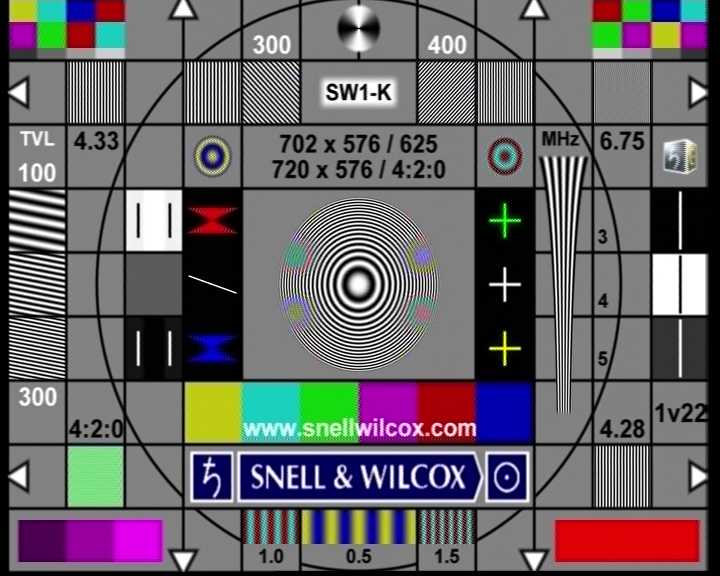

    The first image show comb filter from JVC S-VHS vcr with DigiPure. The spec claim to have 3D comb filter but the test reveal a good 2D adaptive comb filter. So, maybe is not active in passthrough mode the 3D comb filter or is not 3D.
    DVD Player composite OUT >> JVC VCR composite input>> capture card S-Video input
    Second picture show additional cleaning made by 3D comb filter from capture card
    DVD Player composite OUT >> JVC vcr composite input>> capture card composite input
    Picture No. 3 show the comb filter from Panasonic ES15
    DVD player >> Panasonic ES 15 composite input
    Picture No.4 show Hi8 camcorder composite OUT >> composite input JVC vcr S-Video output >> capture card S-Video input

    The card it is built by me and is not available to purchase in stores, but if want one then I can make one. There are some card with 3D comb filter. ATI550, ATI650, ATI750 have 3D comb filter. 650 and 750 have the best 3D comb filter that have seen built in TV Tuners cards but have some issues with AGC and color processor unit with some sources/setup, so may be not a good choice. The 550 is free from this issues but the 3D comb filter is an earlier generation and a bit weaker.
    Here is ATI550 in the same setup as above. It is good but compared with my card, my card has the edge. Also my card have some features that are unavailable in ATI cards or other cards: TBC, frame synchronizer, can capture NTSC tapes with regular PAL vcr - PAL60 support, can capture tapes protected by Macrovision.
    DVD Player composite OUT >> JVC vcr composite input>> ATI550 capture card composite input
