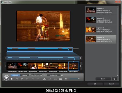

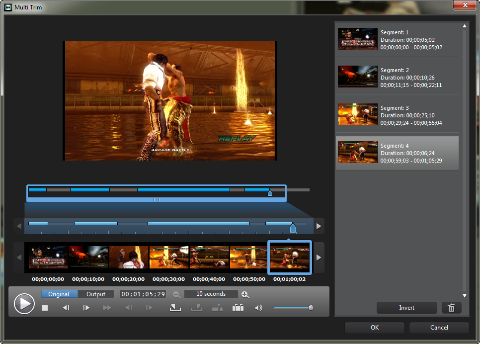

    CYBERLINK POWER DIRECTOR
    Claudio

  8. Lone soldier Cauptain's Avatar
    Jan 2006
    Brazil
    Originally Posted by natalia25 View Post
    I dont know using nero and ask for help...
    I suppose if Vision can't do this (or do it w/o going crazy),
    I'd appreciate recommendations on fairly simple video editing tool(s). I'm an advanced computer user, but not advanced at video editing.
    Easy answer: Power Director (screenshot prove my suggestion)
    Never Cyberlink salesman (But, I like this software).
    Never indicate VEGAS to beginner in video edit.
    I use avisynth to multi-trim..The easiest way for that...
    Claudio
