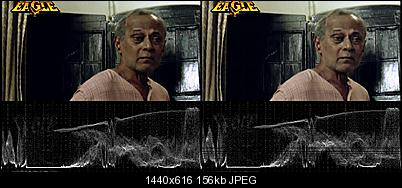

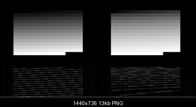

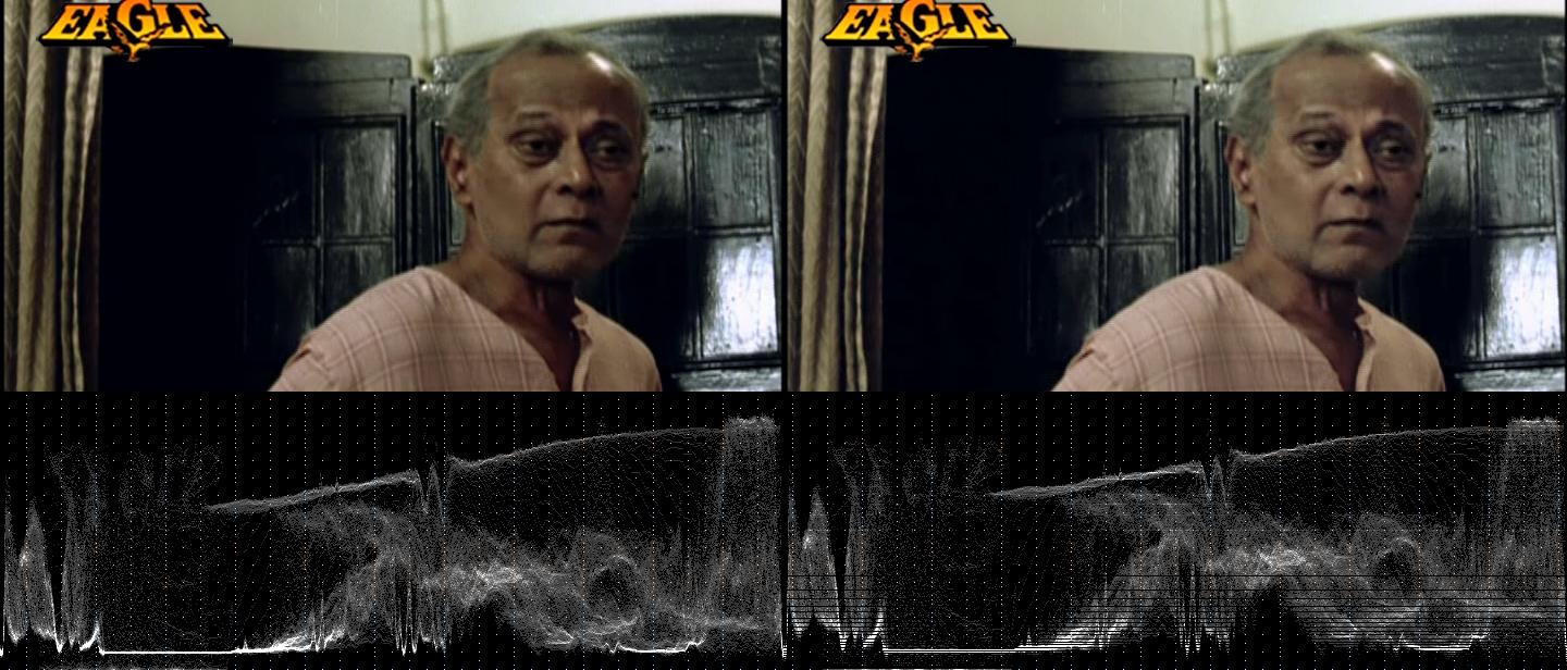

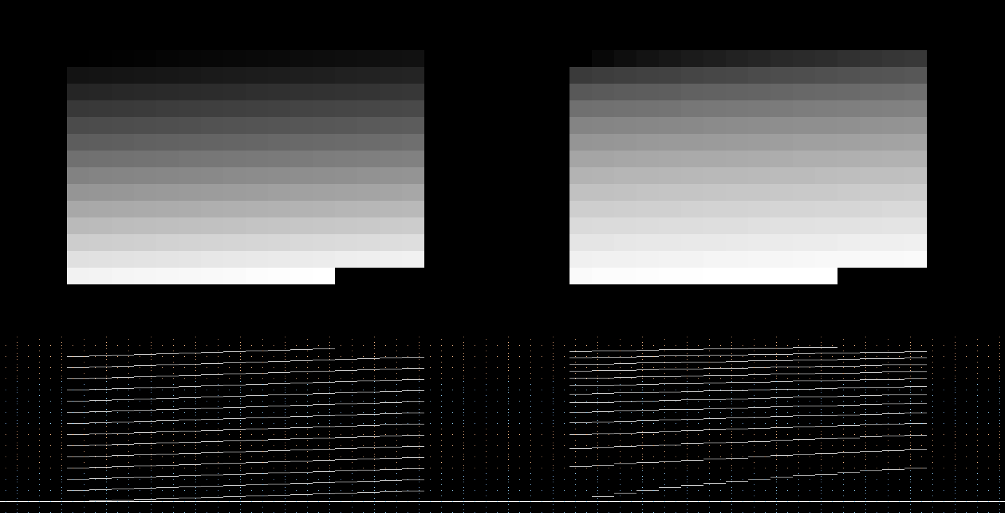

  15. Waveform monitor:
    https://forum.videohelp.com/threads/340804-colorspace-conversation-elaboration?p=212156...=1#post2121568
    In the image I posted earlier I use VideoScope(), not Histogram(). VideoScope doesn't mark the "illegal" regions of Y<16, and Y>235.

  23. Originally Posted by sanlyn View Post
    So here's a first effort on the dark video.
    I think the black level is too high. It looks a little washed out. I'd keep black at y=16 (ignoring the logo and letterbox bars) and use gamma to lighten up the dark areas just above that. Like I did in the sample I posted earlier.

  27. Originally Posted by sanlyn View Post
    I did use gamma. The dark colors of the back of the car seats variy between RGB 13 and 15. That will look pretty black on TV.
    You should be able to see the difference between all 220 shades of gray (Y = 16 to 235, RGB = 0 to 255) on a TV. (In practice the difference between some adjacent shades may not be visible, especially in small patches or when a wide range of brightnesses is being displayed simultaneously.) Many people have the contrast cranked up so that all the darks and brights are crushed. But that's their problem. You shouldn't be accounting for that.
    Any darker, and details in the car'[s interior in the following scene will disappear, and so will the details in the shrubs' shadows outside the car window -- in other words, darker means going back where we started.
    Then use more gamma to increases the difference between near black shades (of course, the cost you pay is a decrease in the contrast of brighter shades). Or use gradations curves with a custom curve (after making sure the luma range is valid).
    The MKV looked pretty good to me, but the blacks bothered me. They aren't black. They're blue.
    I was only addressing the OP's issue of bringing out dark details. I made no attempt to fix the colors (I may have bumped the saturation a bit to compensate for the increased gamma -- I don't remember) or anything else.
    I suspect the video was converted from PAL to NTSC without accounting for North American NTSC setup at the analog stage. Hence all the darks were crushed.
    I agree, they should be distinct. But below comparable values from RGB 60 on down, the differences have been so compressed by crushing that the data for clear delineation isn't there. That, I think, is what crushing is: smooth transitions between darker and more-darker details is just blown away, contours go from dark dark colors to empty black in one step.
    And, yeah, I see TVs all the time running in volcano mode with reds you can see a block away. It's impossible to compensate for that, I just try to target the standards.
    Right, I could see that. That's not a complaint, it's just something I noticed that would need some work. Another pain in the neck with some of the sloppy lab work.
    Likely you're correct. It's a shame, because live movies I see from Indian cinematographers usually look gorgeous. It's shame they screw it up on digital transfers, but that seems to be worldwide.
  30. Originally Posted by baunduley View Post
    dear jagabo
    i'm not so expert so that i can even understand what u've instructed.
    can u please show me the path briefly..........or it was solely for sanlyn, for learning purpose??
    Here's the effect of increasing gamma:
    Be sure to view the image full size.
    On the left is a chart of all 220 shades of grey from Y=16 to Y=235. If you look closely you should be able to see 16 different brightnesses from left to right across each row. These have already been contrast stretched to RGB=0 to RGB=255 as is usually done when converting YUV to RGB for display on an RGB device. The waveform monitor graph below shows the brightness increasing by 1 unit at each horizontal block.
    On the right is the result of ColorYUV(gamma_y=128, off_y=-12), a fairly extreme gamma change. As you can see the overall range of britnesses is the same. But the difference between consecutive dark shades has increased. At the lighter end of the spectrum you can see that the difference between consecutive shades is reduced. For example, the top line of the left graph shows 12 different intensities whereas the top line of the right graph shows only 7 different intensities. So the result of the increasing the gamma is to bring out detail in the darker areas at the expense of losing detail in the lighter areas.
    By the way, you can get a similar effect by using the gamma control in VirtualDub's levels filter. But the Levels feature will not let you bring out details in portions of the picture below Y=16. Because VirtualDub crushes all darks below Y=16 to the same shade of RGB, 0. Your video didn't have much below that level though.
