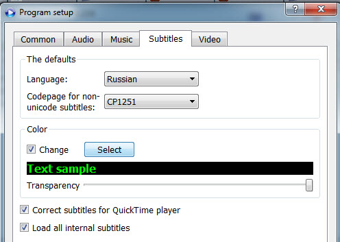

    You go to setup and there is a subtitle tab https://forum.videohelp.com/threads/340675-Mkv%D0%A2%D0%BEMp4-v0-221a-rapid-tool-for-re...ack-Mkv-to-Mp4

  16. Member netmask56's Avatar
    Sep 2005
    Sydney, Australia
  17. I don't think I'm seeing what you want me to see in this post. I don't see anything relevant to hardsubbing.
