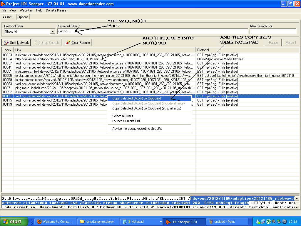

    run rte player and play the programme you want to download (do not open url snooper yet wait until adds are gone)
    so let's say i want to download this of the rte player
    http://www.rte.ie/player/ie/show/10071080/
    ok so now adds are gone open url snooper,make sure this is under keyword filter (swf;hds) press (sniff network)
    when a few lines appear press stop search and pause the rte player,
    you will see below
    ok so now you have
    these 2 lines
    http://www.rte.ie/static/player/swf/osmf2_2012_10_19.swf
    http://vod.hds.rasset.ie/hds-vod/2012/1105/adaptive/20121105_rtetwo-shortscree_cl10071080_10071081_260_/20121105_rtetwo-shortscree_cl10071080_10071081_260__512k.mp4Seg1-Frag18
    You do not need in red
    then you get this
    2012/1105/20121105_rtetwo-shortscree_cl10071080_10071081_260_/20121105_rtetwo-shortscree_cl10071080_10071081_260__512k.mp4
    now we are going to put this together using the first code which is this,just simple take out in red and add replace with the 2 blue below lines,rename the end of it like short instead of FAI

  9. Dunno what you were doing but here is the line you should have copied out of URL Snooper
    Take out the red
    http://vod.hds.rasset.ie/hds-vod/2012/1111/adaptive/20121111_rteone-lovehate_cl10085600_10085601_260_/20121111_rteone-lovehate_cl10085600_10085601_260__512k.mp4Seg1-Frag11
    so you are left with this
    2012/1111/20121111_rteone-lovehate_cl10085600_10085601_260_/20121111_rteon
    put it together within the red below and always use the same swf in blue
    rtmpdump -r "rtmpe://fmsod.rte.ie:1935/rtevod" -a "rtevod" -W
    "http://www.rte.ie/static/player/swf/osmf2_2012_10_19.swf" -y
    "mp4:/2012/1111/20121111_rteone-lovehate_cl10085600_10085601_260_/20121111_rteon
    e-lovehate_cl10085600_10085601_260__512k.mp4" -o "lovehate.flv"
