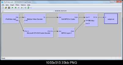

  5. Build a graph with GraphStudio, specify Xvid as the compression codec, configure Xvid, play the graph. I don't have an ACM AC3 encoder installed so I used an MP3 encoder instead. You should get the idea:
  6. the problem is.. if I put the 3dtv Stereo Movie Conversion filter before xvid codec.. the file that result have other settings and I can't control them.. I can't resize, can't change bitrate etc.. without 3dtv Stereo Movie Conversion filter works fine..
  7. The Xvid codec remembers settings from the last time you used it. Use that to your advantage.
