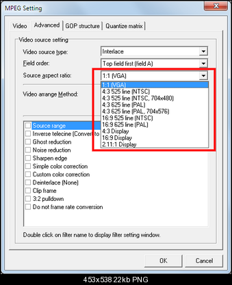

  10. 16:11 is for 704x576 sources. Since your video is 720x576 it's slightly wider than 16:9, hence the resizing and black bars top and bottom. Use 64:45 instead.
    Unless your source is interlaced to start with don't treat it as interlaced and don't encode interlaced. You'll just reduce the quality.

  13. I don't have a newer version of TMPGEnc but the older versions had several source 4:3 settings to choose from:

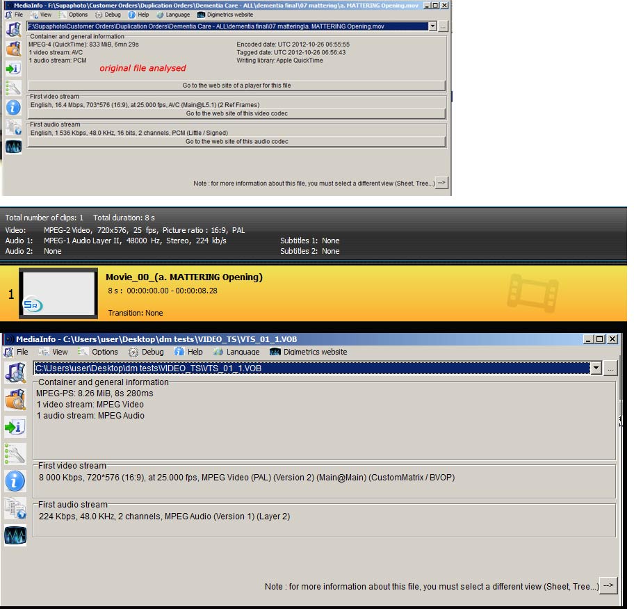

  14. Member Cornucopia's Avatar
    I'm now guessing the problem goes further back than that. A 720x576 DVD-Compliant MPEG2 file (as supposedly output from FCP) OUGHT to be 4:3 or 16:9 intrinsically. If setting those in the encoder puts out something which puts LETTERBOXING onto a widescreen tv, something is being done wrong somewhere (and I hate to say this, but I'm pretty sure it is in how you are adjusting the settings).
    Go back to square one:
    1. Give us a Mediainfo detailed text output of your ORIGINAL files (pre-editing) and/or 10sec. clips of those originals
    2. Give us detailed info on your FCP project & render settings (either text or screencaps)
    3. Give us a Mediainfo detailed text output of your RENDERED FCP files (post-editing) and/or 10 sec. clips from them
    4. Give us detailed info on your TAW project & render settings (again, either text or screencaps)
    5. Give us a Mediainfo detailed text output of your RENDERED TAW files (post-encoding) and/or 10 sec. clips from them
    6. Tell us in thorough detail what model # equipment you use and how you have them set up (both PC hardware & software & CE hardware).
    When troubleshooting, we can only work with clarity when we can isolate and analyze EACH step, independent of the other steps, and removing assumptions.
    BTW, the FIRST thing I would do is set your TV to output "original AR". On my TV, it's called "Set by Program".
  15. devdev devdev's Avatar
    Sep 2003
    ok - great - thank you.
    1. i attach the following images - mediainfo (which contrary to fcexp says 703 x 576) - don't have access tp any pre-editing files
    2. didn't take movie in first place or output so dont have any fc project settings but under item properties, it says that frame size is 720 x 576. pixel aspect PAL - CCIR601
    3. I attach a short clip from the film i've been given which ive exported in fcexp (using quicktime conversion : movie settings: compressor h.264. quality high. key frame rate 24 frame rendering yes encoding mode: multipass dimensions: 636x477)
    4. When i open file up in tmpgenc - in clip settings it says pixel 1:1 progressive and the video below is 25fps 720x576. i changed this to interlace, field order:top field first, pixel 16:11 pal 16:9 . In format section i've changed the aspect ratio to 16:9. then i use TAW to burn disc. when i open up it, in clip settings it recognised it as interlaced, pixel 16:11 pal 16:9 (in video section below 720x576 25fps)
    (this the version that when i viewed it on on a tv at 16:9 setting the image has black bars top and below only this time. If image were to be 'pulled up and down' only to flll screen, then it would look ok since, horizontally, it looks fine to me).
    i attach the taw settings and resulting media info image
    im using windows7, i72600 cpu, 3.40ghz, tmpg vmw5 5.2.4.68, tmpg dvd authoring works 4.1.2.49, ram 8, 64 bit
    and yes, now i've set lg tv to 'original picture'
    thanks to all for taking an interest
