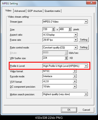

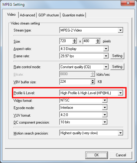

    You said you wanted the maximum MPEG 2 quality, not the maximum DVD quality. DVD is a very small subset of MPEG 2. You won't get perfect results with the max MPEG 2 quality that's DVD compatible. It will be full of macroblocks.
    Originally Posted by Bobbo01 View Post
    2. I don't have a "High Profiles @ High Level" profile in TMPGENC. Where can I find this?
    If you're using a newer version of TMPGEnc, I don't know. In TMPGEnc Plus 2.5:
    [Attachment 14546 - Click to enlarge]
    You might be able to trade off small details and sharpness to get fewer macroblocks by using custom matrices. Also consider reducing the frame size to half D1 (352x480). Some heavy noise filtering will help reduce the bitrate requirement too.

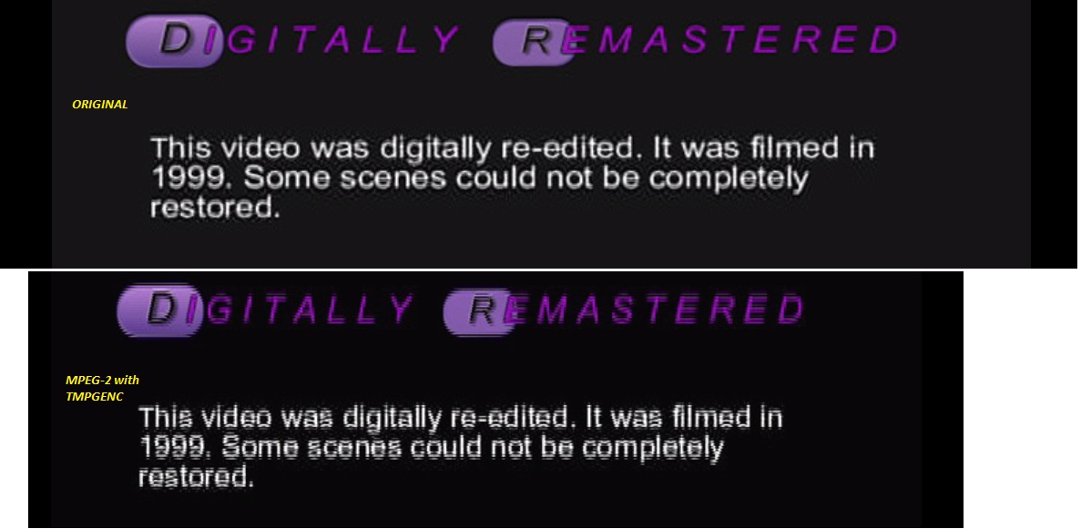

    Thanks for your help. I was not using the "plus" version. I have located and installed that and now all the issues I previously had have gone away. I am able to set a 60K bit rate and have High Profile available.

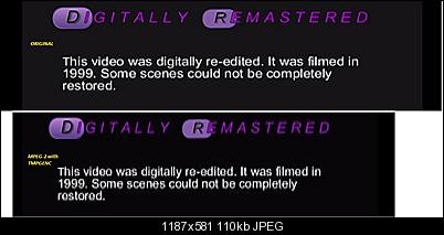

    However, I am still seeing the same results I have always seen. It doesn't seem to matter if I use 60000 or 6000, it looks the same. I can tell right away at the opening title sequence that it doesn't match the source. I changed only the settings you have told me to change, but I get this as my output:
    Notice the difference in the text from the original, vs the mpeg2. How can I make that match the original? I'm sure cleaning that up will have positive affects all over the video.
    Also, why is the size different? I specified automatic (720x480)
    Bob
  16. Your problem has nothing to do with MPEG 2 encoding. You need to change the settings in your MJPEG decoder. Turn off the "swap fields" option. Or, if it's already off, turn it on.
    The size is different because the program you're using to display the MPG file is resizing to adjust for the display aspect ratio (4:3). It's not adjusting the MJPEG AVI (3:2 frame size) because there's no AR information there.

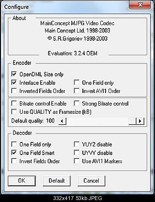

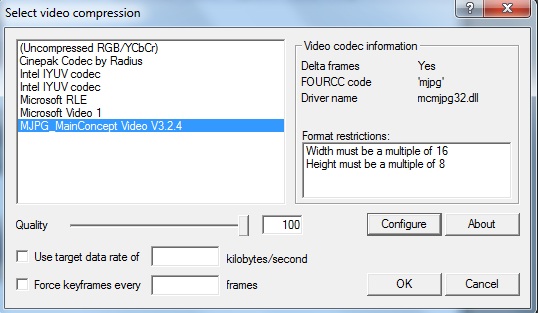

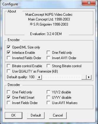

    Going through VirtualDub, I was able to find the settings for my MainConcept MJPEG codec:
    Do I just change "invert fields" at the bottom? Do I need to change any other settings here? Will these settings impact the conversion in TMPGENC? (I'm sort of confused on exactly how the codec interracts with conversion tool...I always have been)
    Also, I have other codecs installed - do I need to worry about any of these? Which one will my playback default to?

  18. In order for a program to process a video file it has to first decompress the video. There are two video subsystems in Windows: the older VFW (Video For Windows) and the newer DirectShow. In addition to those, any program can use its own internal codecs. The MJPEG codec you are accessing with VirtualDub is a VFW codec. TMPGEnc Plus can use VFW or DirectShow decoders. I'm not sure about newer versions of TMPGEnc.
    I'm not familiar with MC's MJPEG decoder. The Inverted Fields Order setting (in the Decoder section) might be the one you want.
    Basically, some old video capture devices stored the scan lines in the wrong order. Instead of lines 0, 1, 2, 3, 4, 5... they swapped each pair of scan lines: 1, 0, 3, 2, 5, 4... So MJPEG decoders usually have the option to restore the correct scan line order. Your MPEG 2 encoded image showed exactly that.

    If I'm understanding this correctly, my main problem appears to be interlaced content that is being displayed wrong. Is that right?
    Would I be better off just running the source material through intelligent interlace filters (NOT deinterlace), to correct the field order issues, and then convert to MPEG2?
    My hopes is that this would eliminate the problems I experience when playing back on VLC player and DVD player. I would have to do some research on interlace filtering.

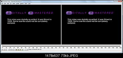

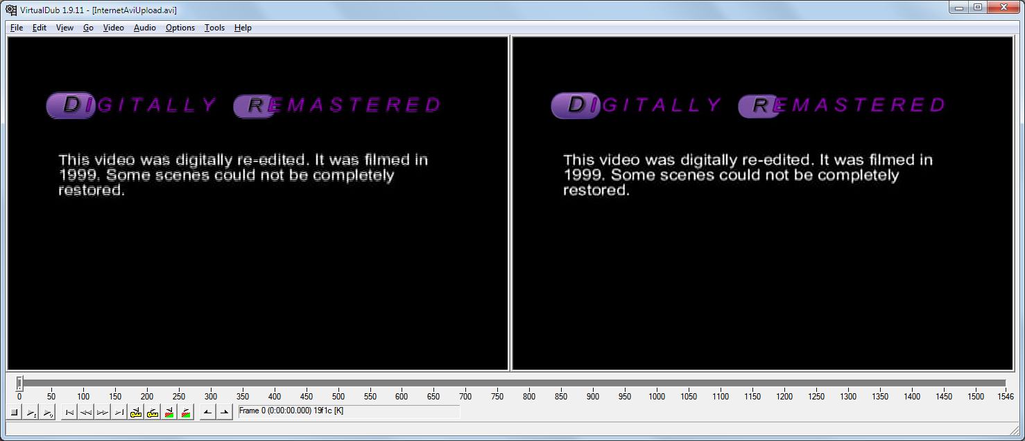

  21. VirtualDub also has a built in MJPEG decoder. It also has a Field Swap filter that does the same thing as the option in MJPEG decoders. Your source file opened with VirtualDub's internal MJPEG decoder, then field swapped:
    You can force TMPGEnc to use VFW by moving the AVI source filters to the top of the list: Option -> Environment Setting -> VFAPI Plug-in.
    AviSynth has the SwapFields() function.

    The field swap in VDUB totally fixed it! Thank you!!!
