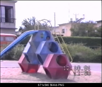

    So here is two pictures of the same frame of the video.
    Photo One is when the script runs (code above) :

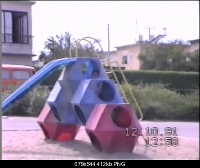

    And the second image with this code: (no ReplaceFramesMC)
    AviSource("step 1 - filtered.avi")
    Crop(8,0,-16,-16)
    There is a big difference in sharpness if you check out the pictures one by one.
    It's not really bad if you bring me a new code of ReplaceFramesMC Which does not affect sharpness of the video.
